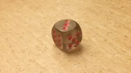

Here is a picture of a die:

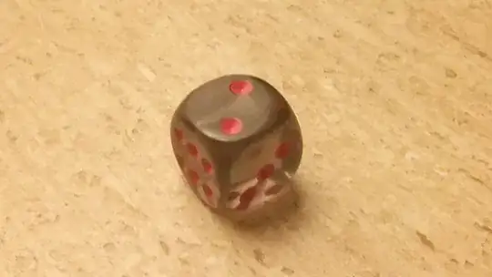

Now let's spin it $90^\circ$ clockwise. The die now shows

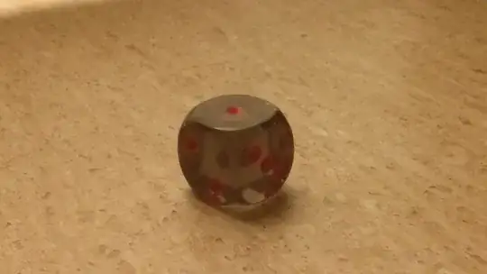

After that, if we flip the left face up, the die lands at

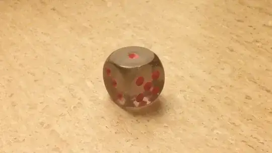

Now, let's do it the other way around: We start with the die in the same position:
Flip the left face up:

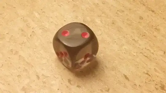

and then $90^\circ$ clockwise
If we do it one way, we end up with $3$ on the top and $5, 6$ facing us, while if we do it the other way we end up with $2$ on the top and $1, 3$ facing us. This demonstrates that the two rotations do not commute.
Since so many in the comments have come to the conclusion that this is not a complete answer, here are a few more thoughts:

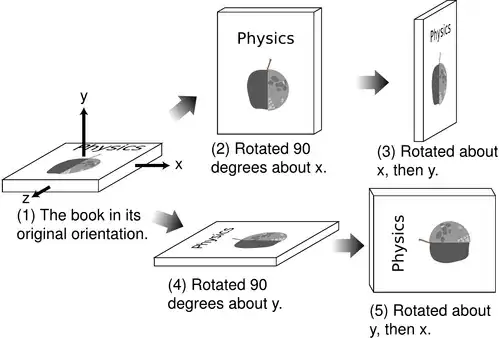

  • @CameronWilliams Here is a picture with a rotated book, with explanations in the picture: https://universe-review.ca/I15-18-nonAbelian.jpg – Jeppe Stig Nielsen Nov 17 '16 at 12:11

Here is a pictorial explanation equivalent to Arthur's answer:
http://www.lightandmatter.com/html_books/genrel/ch07/figs/noncommuting-rotations.png
(Picture source: Benjamin Crowell, General Relativity, p. 256.)
