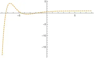

I can plot you this series, for $k$ from $0$ to $100$, and $\nu$ from $-8$ to $+8$, to show you the partial behavior, if it helps:
