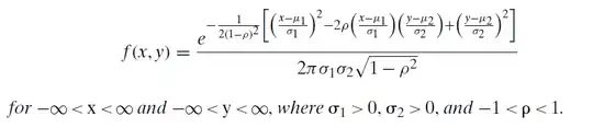

A pair of random variables $X$ and $Y$ have a bivariate normal distribution and they are referred to as jointly normally distribed random variables if and if their joint probability density is given by

Does one re arrange the formula so that one can just plug in what $\mu_{1} \text{ and } \mu_{2}$ are? Does one substitute like this?
$$f(x,y) = \frac{-1}{54} *(x^2+4y^2+2xy+2x+8y+4) \\ = \frac{1}{-54} \left[ (x-\mu_{1})^2 +2(x-\mu_{1})(y-\mu_{2})+4(y-\mu_{2})^2 \right]$$

If we substitute $\mu_1=0$ and $\mu_2=-1$ in the exponent of $e $ of the joint probability density formula, we get
$$\displaystyle -\frac 1{2(1-\rho^2)}\left[\left(\frac{x}{\sigma_1}\right)^2 -2\rho \left(\frac{x}{\sigma_1}\right) \left(\frac{y+1}{\sigma_2}\right) +\left(\frac{y+1}{\sigma_2}\right)^2\right]$$
Expanding it, we have
$$-\frac 1{2(1-\rho^2)} \left[\frac{1}{\sigma_1^2}x^2 +\frac{1}{\sigma_2^2} y^2 - \frac{ 2\rho }{\sigma_1 \sigma_2} xy - \frac{ 2\rho }{\sigma_1 \sigma_2} x + \frac{2y}{\sigma_2^2} + \frac{1}{\sigma_2^2} \right]$$

Comparing this expression with
$$-\frac {1}{54} \left[x^2 +4 y^2+2 xy +2 x + 8y + 4 \right]$$
which is provided in the OP we directly get $\sigma_1=k \,\,$, $\sigma_2=k/2\,\,$ (note that both variances are by definition positive), and $\rho=-1/2\,\,$. So we have
$$-\frac {1}{2k^2 \left(1-\left (\frac {1}{2} \right)^2 \right)} =-\frac {1}{54} $$
and then $k=\pm 6\,\,$. This leads to $\sigma_1^2=36\,\,$ and $\sigma_2^2=9\,\,$.

That's pretty much it, though the exponent should be $$ -\frac 1{2(1-\rho^2)}\left[\left(\frac{x-\mu_1}{\sigma_1}\right)^2 -2\rho\left(\frac{x-\mu_1}{\sigma_1}\right)\left(\frac{y-\mu_2}{\sigma_2}\right) +\left(\frac{y-\mu_2}{\sigma_2}\right)^2\right]\tag1 $$ (note the denominator in the factor in front is $(1-\rho^2)$, not $(1-\rho)^2$.)
There's no need to look at conditional distributions, just compare (1) to the given exponent. Employing the common denominator $\sigma_1^2\sigma_2^2$ inside the square brackets, (1) is equal to $$ -\frac 1{2(1-\rho^2)\sigma_1^2\sigma_2^2}\left[\sigma_2^2(x-\mu_1)^2 -2\rho\sigma_1\sigma_2(x-\mu_1)(y-\mu_2) +\sigma_1^2(y-\mu_2)^2\right].\tag2 $$ Now it's a matter of equating coefficients and solving for the unknowns. Notice that the ratio between the coefficient on $x^2$ and the coefficient on $y^2$ is $(\sigma_2/\sigma_1)^2$, so now you have the value for $\sigma_2/\sigma_1$. Also the ratio between the coefficients on $xy$ and $y^2$ is $-2\rho(\sigma_2/\sigma_1)$. This allows you to solve for $\rho$. Knowing the value of $\rho$, you inspect the coefficient on $x^2$ to read off $\sigma_1$, and now you can determine $\sigma_2$.
