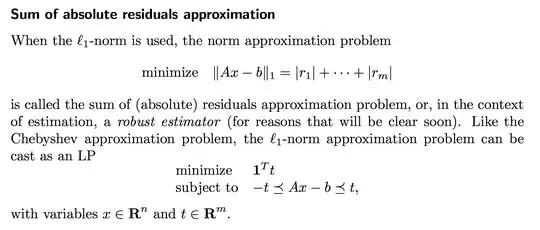

Addendum
From section 6.1.1 of Boyd & Vandenberghe:
