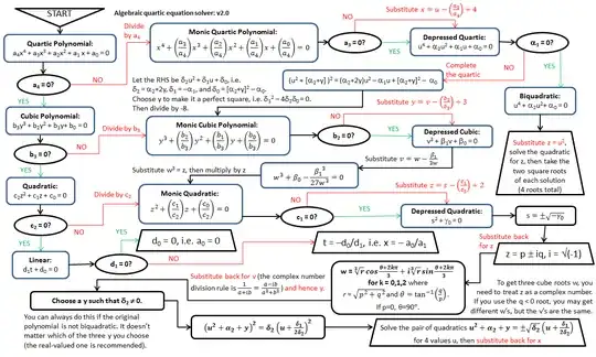

I'd like to show you this flowchart which summarizes all methods of solving up to quartic polynomials manually: flowchart
flawr
  • 16,931
    That is pretty awesome. But I think there is a typo in the reduction from quartic to cubic (look at the degrees of $u$). Did you make this? – DanielV Dec 23 '14 at 09:55
    No I just found it once on reddit, but never found the original source =/ http://www.reddit.com/r/math/comments/2679hf/algebraic_quartic_equation_solver_diagram/ I think I have to check everything and rewrite it one day. – flawr Dec 23 '14 at 09:56
