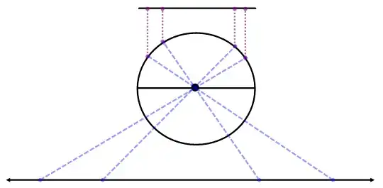

Here is a nice one ${}{}{}{}{}{}{}{}{}$, can you find the equation?

@The Chaz 2.0 If the diameter of the circle is 1 and the interval is $(0, 1)$ and 1/2 mapped to 0 and the distance between the center of the circle and the 2nd numberline is 1/2 then the formula is $f(x)=\frac{x-1/2}{\sqrt{x-x^2}}$. Becouse scaling does not matter you can multiply by 2 and get the formula $f(x)=\frac{2x-1}{\sqrt{x-x^2}}$, but i don't know how you can get Cameron Buie's formula, out of this. – 05storm26 Feb 02 '14 at 08:31
I am thinking about: $f:(0,1)\to\mathbb{R}$, $f(x)=-\cot\left(\pi x\right)$ – Darius Apr 22 '14 at 19:58
2As far as I can tell, the connection between our answers' formulae is coincidental (aside from the fact that if $g$ is a positive function on some subset of $\Bbb R,$ then so is $\sqrt{g},$ so our functions are related, but not in an obvious heuristic way. Please let me know if you can discern a connection between our answers (aside from the obvious algebraic one). – Cameron Buie Oct 31 '14 at 03:07
2@TheChaz2.0 If you vary $x$ from $-\frac{\pi}{2}$ to $\frac{\pi}{2}$, $\frac{1+\sin x}{2}$ will vary from $0$ to $1$ and $\tan x$ will vary from $-\infty$ to $\infty$. As both of these are bijections, you can take composition of inverse of first function and the second function to get the desired function. – Prince Kumar Dec 03 '16 at 14:04
@05storm26 I've been out of geometry longer then I thought-you baffled me how you obtained the explicit formula.Can you give me some detail? Maybe I was just exhausted at 3 am. The answer's probably very easy and I'm gonna kick myself when I see it. – Mathemagician1234 Mar 19 '19 at 06:46
1@Mathemagician1234 a simple way is to observe that, if $x\in[-1,1]$ is the coordinate on the circle's diameter, $\arccos(x)$ is the corresponding angle, and $\cot(\arccos(x))=x/\sqrt{1-x^2}$ the corresponding projection on a line sitting above the circle. This gives a bijection $[-1,1]\to\mathbb R$. You can then simply map $x\mapsto 2x-1$ to get the bijection on $[0,1]$ (note that $1-(2x-1)^2=4(x-x^2)$) – glS Oct 15 '20 at 23:03

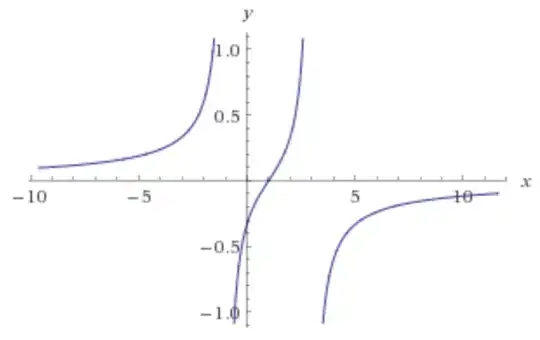

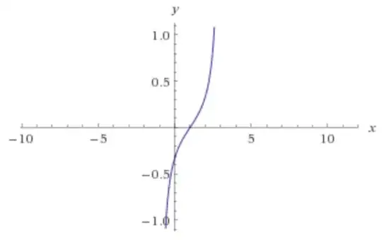

A homeomorphism (continuous bijection with a continuous inverse) would be $f:(0,1)\to\Bbb R$ given by $$f(x)=\frac{2x-1}{x-x^2}.$$
Added: Let me provide some explanation of how I came by this answer, rather than simply leave it as an unmotivated (though effective) formula and claim in perpetuity.
Many moons ago, I was assigned the task of demonstrating that the real interval $(-1,1)$ was in bijection with $\Bbb R.$ Prior experience with rational functions had shown me graphs like this:
The above is a graph of a continuous function from most of $\Bbb R$ onto $\Bbb R.$ This doesn't do the trick on its own, since it certainly isn't injective. However, it occurred to me that if we restrict the function to the open interval between the two vertical asymptotes, we get this graph, instead:
This graph is of a continuous, injective (more precisely, increasing) function from a bounded open interval of $\Bbb R$ onto $\Bbb R.$ This showed that rational functions could do the job. Other options occurred to me, certainly (such as trigonometric functions), but of the ideas I had (and given the results I was allowed to use) at the time, the most straightforward approach turned out to be using rational functions.

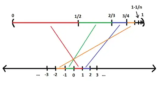

For a less differentiable example, consider the bijection in the following picture,
In symbols, given $x \in (0,1)$ let $n$ be the largest natural number such that $1-\frac{1}{n}<x$, define $$y=\frac{x-n}{\frac{1}{n}-\frac{1}{n+1}}$$ to be the renormalized version of $x$ if the interval $(1-\frac{1}{n},1-\frac{1}{n+1}]$ is rescaled and shifted to map to $(0,1)$. Then we have the following bijection: $$f(x)=\begin{cases}\frac{n-1}{2}+y,& n \text{ odd} \\ -\frac{n-2}{2}-y,& n \text{ even}\end{cases}$$

1Here is a more visual description of the same function (modulo a factor of $\pi$)
Bend the line segment (0, 1) into a semicircle, with the open part facing upwards, and rest it on the real line (with 0.5 on the semicircle resting on 0 on the real line). To map a point on one line to a point on the other, draw a line through that point and the centre of the circle. The mapped point is where it intersects the other line.
– Max Sep 21 '12 at 10:10 -
Of course, knowing the domain and range simply guarantees that $f$ is surjective, but this $f$ does turn out to be injective, too. – Cameron Buie Sep 21 '12 at 10:36
