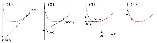

Assume oneself (= target) at the origin of the euclidian plane, darting upwards along the positive $y$ axis towards the midpoint between two lions symmetric to the axis. The phases of the ensuing pursuit are described in the following (based on the animation at Wolfram's pursuit curve page).
  • (1) Pursuit starts at $t=0$ with the lion staring down at the origin.
  • (2) At each moment in time the lion aims directly towards its target.
  • (3) Since the pursuer goes downwards while the target moves upwards, they will be level at some point, after which the pursuer will turn upwards as well. If at this $t=t_1$ the abscissa of the lion is less than its reach $x_1 \le 1$ then the gap is closed and the target has been captured.
  • (4) Otherwise the target has escaped, and the lion will continue chasing it pointlessly.

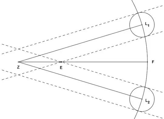

First, some considerations. Both your body size and the lions' body size don't matter since all of them are considered points. Also the 1-meter limit around each lion acts like a circular force field around it, so if you enter its reach you're literally dead meat.
The lions are equally spaced around a circle of radius 200 meters, then you may consider they're exactly located at the vertices of a regular polygon with $X$ sides; also the lions are dumb since they do not cooperate and their trajectory from the starting position is a straight line toward the center, as show in figure 1 below.

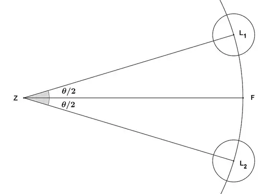

Figure 1: your starting point $Z$ and two adjacent lions $L_{1}$ and $L_{2}$. Figure 1: your starting point $Z$ and two adjacent lions $L_{1}$ and $L_{2}$.
Since the lions are equally spaced, your best strategy is to take the shortest path out of the circular field, i.e., a radius. Take the line coincident to the bisector angle equally distant between two adjacent lions' trajectory lines.
Notice the lions trajectories do not cover all the field area, they leave some gap behind; the dangerous moment only occurs when their "force field" trajectory touch each other at the exact moment they also reach your trajectory. It means there is an encounter point $E$ intersecting your trajectory and their (represented as dashed lines) as shown in figure 2 below.
Figure 2: lions trajectory Figure 2: lions' trajectories and the encounter point $E$.

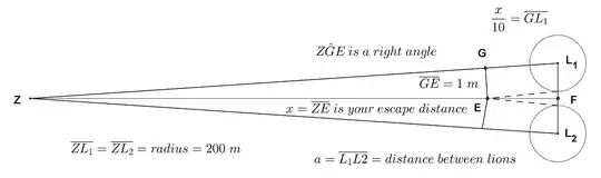

Now imagine the minimum scenario where you can escape. Then you reach the escape point $E$ almost at the same time the lion's force field does. The following figure 3 is almost self-explicative:
Figure 3: a minimum narrow escape. Figure 3: a minimum narrow escape.
Remember you run ten times faster than any lion. Thus your escape distance $x=\overline{ZE}$ takes the same time a fat lion takes to walk the distance $\dfrac{x}{10}=\overline{GL_{1}}$
$ZGE$ is a right triangle such that $\overline{ZG}=r-\dfrac{x}{10}$. Thus it's possible to find your minimal escape distance, \begin{equation*} \left(\overline{ZE}\right)^{2}=\left(\overline{GE}\right)^{2}+\left(\overline{ZG}\right)^{2} \end{equation*} \begin{equation*} x^{2}=1^{2}+\left(r-\dfrac{x}{10}\right)^{2} \end{equation*} \begin{equation*} x^{2}=1+200^{2}-40x+\dfrac{x^{2}}{100} \end{equation*} \begin{equation*} x^{2}-\dfrac{x^{2}}{100}+40x-40001=0 \end{equation*} has a positive root $x=181.82068\;m$ is your escape distance.
With this value, you can find the minimal distance between two adjacent lions such that you can escape. \begin{equation*} \sin\dfrac{\theta}{2}=\dfrac{\overline{GE}}{\overline{ZE}}=\dfrac{\overline{FL_{1}}}{\overline{ZL_{1}}} \end{equation*} \begin{equation*} \dfrac{1}{x}=\dfrac{a/2}{r} \end{equation*} \begin{equation*} a=\dfrac{2r}{x} \end{equation*} \begin{equation*} a=\dfrac{2\cdot200}{181.82068} \end{equation*} \begin{equation*} a=2.19997\;m \end{equation*} this is the distance between lions in the minimum scenario where you can escape (approximately 2-force-fields plus $20\;cm$, remember you're point size).
Now look at the angle \begin{equation*} \sin\dfrac{\theta}{2}=\dfrac{1}{x} \end{equation*} \begin{equation*} \dfrac{\theta}{2}=\sin^{-1}\left(\dfrac{1}{x}\right) \end{equation*} \begin{equation*} \theta=2\cdot\sin^{-1}\left(\dfrac{1}{181.82068}\right) \end{equation*} \begin{equation*} \theta=0.630248^{\circ} \end{equation*} Thus $X$ is the result of the division \begin{equation*} X=\dfrac{360^{\circ}}{\theta}=\dfrac{360^{\circ}}{0.630248^{\circ}}=571.204 \end{equation*} Therefore, $X\leq571$ is the improved value.
