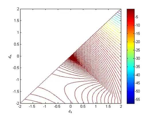

So the problem boils down to a condition on just two variables. After some massaging of the right-hand side, the condition to be shown is: $$2k_0(n-k_0-0.5Dn)(e^{d_1}-e^{d_n})-Dn^2e^{d_n}\stackrel{?}{\leqslant}0.$$
This seems to check out empirically. We can also note that whenever $D\geqslant 2$, all coefficients are nonpositive, so we can restrict our search to $-2\leqslant d_n \leqslant d_1 \leqslant 2$.
That's as far as I've gotten. If someone has any ideas on how to prove this, it would be much appreciated.
EDIT: So here's what this looks like. It's maximised at $(d_1,d_n)=(0,0)$ with value $0$, and as you head towards $(-2,-2)$, it drops and then starts tending to zero again. This is for $n=2$ but it's pretty much the same for any $n$.
