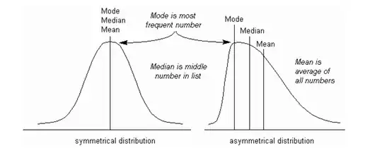

In my eyes, the intuitive explanation is that the ML estimates the conditional mode (the maximum of the distribution), the least squares the conditional mean. In the case, where the errors are perfectly Gaussian distributed are this estimates equal. Distribution of errors
