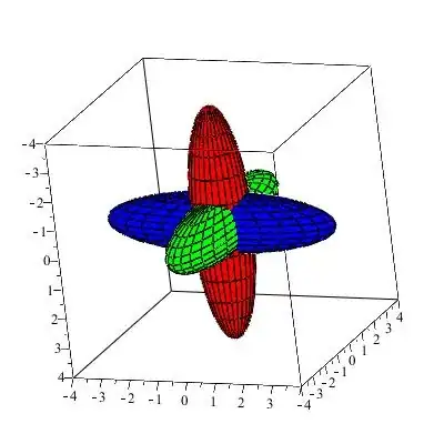

I may be mistaken (i.e. criticism is very welcomed), but I think I was able to rigorously prove the following: Define two ellipses to be simply intersecting if they intersect in exactly two points. Then we say that two ellipsoids are simply intersecting if they intersect in two simply intersecting ellipses.
Proposition: Let $E$ be an arrangement of n ellipsoids in 3-space, let $N$ be the number of regions into which $E$ divides 3-space, and let $M=n(4n^{2}-9n+11)/3$. If
  1. Any two ellipsoids in $E$ are simply intersecting, and
  2. Any three ellipsoids in $E$ intersect in 8 points, and
  3. Any four or more ellipsoids have empy intersection,
then $N=M$. Otherwise, $N<M$.
Very roughly speaking, If 1-3 hold, then we look at how one of the ellipsoids is divided into patches by the other $n-1$ ellipsoids,and see in which way each of these patches divides a region formed by the other $n-1$ ellipsoids. This gives us a way to count regions. If either of 1-3 fails then the a similar idea will yield less patches and hence less regions.
For example, $x^{2}+(y/4)^{2}+z^{2}=1$ (blue), $(x/4)^{2}+y^{2}+z^{2}=1$ (green), and $x^{2}+y^{2}+(z/4)^{2}=1$ (red) will yield the maximum (20 regions)Three ellipsoids
Note that linear independence of the defining equations is not sufficient to guarantee that the maximum number of regions is obtained. E.g. $(x/2)^2+(y/4)^2+z^2=1$, $(x/4)^2+y^2+(z/2)^2=1$ intersect in two disjoing ellipses, and yield only 5 regions.
The methods and ideas I have used also work in dimension 2, and I will probably add more later to this answer about the general case in dimension $\ge 4$. This will all be part of an upcoming paper.
