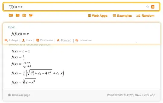

Seems simple enough, but I have no idea how one would get all solutions to this. Wolfram Alpha gives $5$ answers, the first $2$ of which I could get myself, but the following $3$ completely defeat me.

4Such functions are known as involutions. In general, given an invertible function $g$, $f(x)=g^{-1}(-g(x))$ is an involution. – Workaholic Sep 22 '16 at 12:58
7This is simple indeed, only on an entirely different level. There is a great deal of solutions, not just mere 5 or 50. – Ivan Neretin Sep 22 '16 at 13:02
I think it would suffice to prove that $f(x)=x$ is the only solution of this functional equation. – Student Sep 22 '16 at 13:08
1At first I thought the question was how to solve $f(f(x) = x$ for $x$. Obviously that depends on $f$! Now I understand the question is how to solve $f \circ f = \text{Id}$ for $f$, which is definitely nontrivial. – Matthew Leingang Sep 22 '16 at 13:09
@ShreyAryan But it isn't. Depending on the domain of $f$ there are other solutions (and $\sqrt[3]{1-x^3}$ is a solution on $\mathbb{R}$). – Winther Sep 22 '16 at 13:09
1interesting question (+1) – tired Sep 22 '16 at 13:10
2notice also that solutions one and two are special cases of the solution 3 – tired Sep 22 '16 at 13:12
Involution. Related MSE questions: (1), (2) – Winther Sep 22 '16 at 13:17
Yeah, I thought this must have been asked before. So in fact, this question is a duplicate, and so is my answer (both halves of it). There were many before it. Wonder why the "Related" column didn't put them forth. – Ivan Neretin Sep 22 '16 at 14:07
Even $\frac{x}{\sqrt{x^2-1}}$ satisfies it. – Aman Sharma Apr 23 '17 at 11:32
