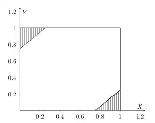

For one of the line segments to be more than $0.75$ cm, then the following are the conditions where this is satisfied
$$ X > 0.75 \text{ and } Y > 0.75 \Rightarrow P(X > 0.75, Y > 0.75)=1/16 \\ Y < 0.25 \text{ and } X < 0.25, \Rightarrow P(Y < 0.25, X < 0.25)=1/16 \\ Y - X > 0.75 \text{ if } Y > X\\ X - Y > 0.75 \text{ if } X > Y $$
To calculate the probability for the latter two conditions, let us visualize this graphically. solution_to_part_a
The area of the two triangles together is $$2 * \frac{1}{2} * \frac{1}{4} * \frac{1}{4} = \frac{1}{16}$$ Hence the probability that one line segment is longer than $75$ cm is $$3 * \frac{1}{16} = \frac{3}{16}$$

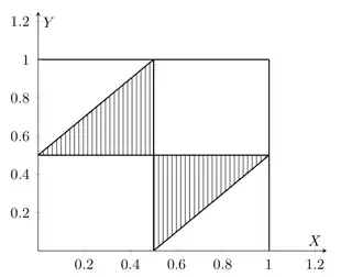

For these three line segments to form a triangle, the following conditions must be satisfied
$$ X + Y - X > 1 - Y \Rightarrow Y > 1/2 \\ Y -X + 1 - Y > X \Rightarrow X < 1/2 \\ X + 1 - Y > Y - X \Rightarrow Y < X + 1/2 $$
This is for the case assuming $Y > X$. We can write another set of 3 equivalent equations for the case $X >Y$. Visualizing these two feasible regions on a graph, we get
solution_to_part_b
The total area of the shaded figure, and hence the probability that the three line segments form a triangle is
$$2 * \frac{1}{2} * \frac{1}{2} * \frac{1}{2} = \frac{1}{4}$$
