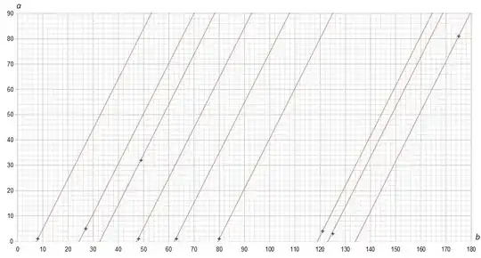

My question A conjecture with connection to the $abc$-conjecture is about a conjectured injection from exceptional $abc$-triplets $(a,b,c)\mapsto a^2+b^2$, but this question is about a conjectured injection from exceptional $abc$-triplets $(a,b,c)\mapsto a+2b$. It's similar but not a duplicate.
The numbers $\,a,b,c\,$ is a $abc$-triplet if they are coprime and $a+b=c$. One version of the abc-conjecture is then:
For all $\varepsilon>0$ the set $E_\varepsilon$ of all $abc$-triplets with $c>\text{rad}(a\cdot b\cdot c)^{1+\varepsilon}$ is finite. where $\,\text{rad}(p_1^{n1}\cdots p_k^{n_k})=p_1\cdots p_k$ and $\,p_1,\dots ,p_k$ are arbitrary primes.
But it is known that $E_0$ is infinite. Conjecture:
For $abc$-triplets, where $a<b$,
$(a,b,c),(a',b',c')\in E_0\,$ and $\,a+2b=a'+2b'\implies \{a,b\}=\{a',b'\}$
So far tested for all $a,b$ less than $100,000$. Can this be proved?
There is no uniqueness for $a+b$, $a-b$ or $2a+b$.
