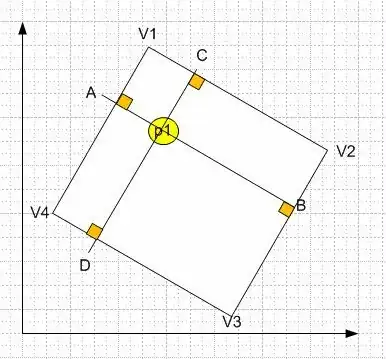

40
I would use a "point-in-convex-polygon" function; this works by checking whether the point is "to the left of" each of the four lines.
binn
  • 1,321
35
For example, if all the triangles $ABP$, $BCP$, $CDP$, $DAP$ are positively oriented; for $ABP$ this can be tested by checking the sign of $(x-x_1)\cdot(y-y_2)-(y-y_1)\cdot(x-x_2)$. This method generalizes to convex polygons.
Alternatively, find a transformation that makes the rectangle parallel to the axes. Apply the same transformation to your point at the test is simple. This is especially helpful if you want to test many points against the same rectangle.
    I didn't understand what we're concluding by checking the sign of that expression, and how it relates to the point being inside the polygon. Could you please explain? – stoic-santiago Feb 19 '18 at 04:39
  • @arya_stark You can find if two points lie on the same side of a line by substituting the co-ordinates of the point in the line equation and checking their signs' agreement. – Balakrishnan Rajan Mar 25 '19 at 02:58

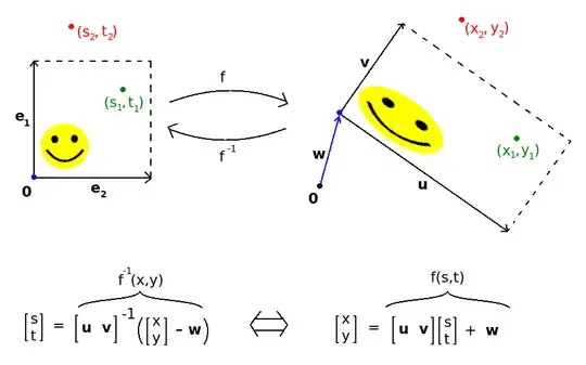

28
Given how much attention this post has gotten and how long ago it was asked, I'm surprised that no one here mentioned the following method.
A rectangle is the image of the unit square under an affine map. Simply apply the inverse of this affine map to the point in question, and then check if the result is in the unit square or not.
To make things clear, consider the following image, affine map
where the vectors in the pictures are $\mathbf{u} = c - d$, $\mathbf{v} = a - d$, and $\mathbf{w} = d$.
Since the legs of a rectangle are perpendicular, the matrix $\begin{bmatrix}\mathbf{u} & \mathbf{v}\end{bmatrix}$ is orthogonal and so we even have a simple formula for the inverse: $$\begin{bmatrix}\mathbf{u} & \mathbf{v}\end{bmatrix}^{-1} = \begin{bmatrix}\mathbf{u}^T/||u||^2 \\ \mathbf{v}^T/||v||^2\end{bmatrix}.$$
If you want to check many points for the same rectangle, this matrix can be easily precomputed and stored, so that you perform the (typically more expensive) division operations only once at the start. Then you only need to do a few multiplications, additions, and subtractions for each point you are testing.
This method also applies more generally to checking whether a point is in a parallelogram, though in the parallelogram case the matrix inverse does not take such a simple form.
Nick Alger
  • 19,977
    Thanks Nick, came here and wanted to see this exact reply – Robert Monfera Apr 28 '18 at 23:21
    I'm confused why isn't this post upvoted the most – Amira Oct 05 '21 at 21:53
    @Amira I think because I posted this answer several years after the question was asked. By the way, this matrix formula, if you write it out and perform some algebraic manipulations, can be transformed into the mysterious formula in the highest upvoted answer by Raymond Manzoni. – Nick Alger Oct 05 '21 at 22:47

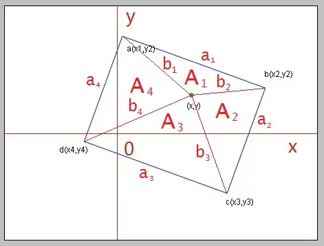

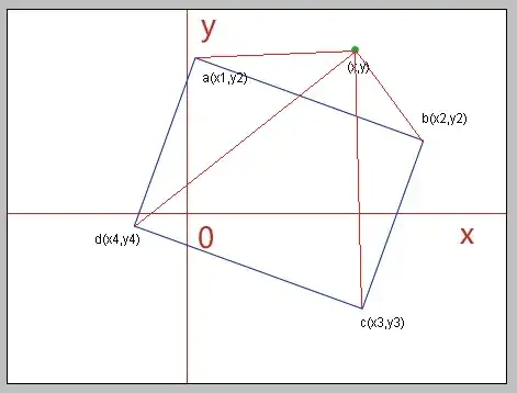

17
Inside
The point is inside the rectangle.
Outside
The point is outside the rectangle.
Let us define:
A: area of the rectangle
Ai: areas of the triangles shown in the pictures. (i = 1, 2, 3, 4)
ai: lengths of the edges shown in the pictures. (i = 1, 2, 3, 4)
bi: lengths of the line segments connecting the point and the corners. (i = 1, 2, 3, 4)
If the point is inside the rectangle, the following equation holds:
$ \mathbf{A = A_1 + A_2 + A_3 + A_4} $
If the point is outside the rectangle, the following inequality holds:
$ \mathbf{A > A_1 + A_2 + A_3 + A_4} $
How do we calculate A, A1, A2, A3, A4, a1, a2, a3, a4, b1, b2, b3 and b4?
First we calculate the edge lengths:
$ a_1 = \sqrt{(x_1 - x_2)^2 + (y_1 - y_2)^2} \\ a_2 = \sqrt{(x_2 - x_3)^2 + (y_2 - y_3)^2} \\ a_3 = \sqrt{(x_3 - x_4)^2 + (y_3 - y_4)^2} \\ a_4 = \sqrt{(x_4 - x_1)^2 + (y_4 - y_1)^2} $
Next we calculate the lengths of the line segments:
$ b_1 = \sqrt{(x_1 - x)^2 + (y_1 - y)^2} \\ b_2 = \sqrt{(x_2 - x)^2 + (y_2 - y)^2} \\ b_3 = \sqrt{(x_3 - x)^2 + (y_3 - y)^2} \\ b_4 = \sqrt{(x_4 - x)^2 + (y_4 - y)^2} $
Then we calculate the areas using Heron's Formula:
$ A \,\,\, = a_1a_2 = a_2a_3 = a_3a_4 = a_4a_1 \\ u_1 = \frac{a_1 + b_1 + b_2}{2} \\ u_2 = \frac{a_2 + b_2 + b_3}{2} \\ u_3 = \frac{a_3 + b_3 + b_4}{2} \\ u_4 = \frac{a_4 + b_4 + b_1}{2} \\ A_1 = \sqrt{u_1(u_1 - a_1)(u_1 - b_1)(u_1 - b_2)} \\ A_2 = \sqrt{u_2(u_2 - a_2)(u_2 - b_2)(u_2 - b_3)} \\ A_3 = \sqrt{u_3(u_3 - a_3)(u_3 - b_3)(u_3 - b_4)} \\ A_4 = \sqrt{u_4(u_4 - a_4)(u_4 - b_4)(u_4 - b_1)} $
Finally you can do the area test to check if the point is inside or outside the rectangle.

This is equivalent to Raymond Manzoni's answer, but I thought it worth deriving in this fashion.
Kevin Reid
  • 1,006
This is intutition at work, but what if you found the distances from the vertices to the point and added them all up?
Your min would be the distances to the center of the rectangle and your max is the distances if your point was on one of the vertices.
For example, for a 3x4 triangle, you min would be 10 (two times your diagonal) and your max would be 12 (if your point was on a vertex). This is your range: the point is inside the rectangle, if your distances from the vertices to the point are within the range 10 to 12 (for a 3x4 rectangle).

I had this observation and it may be useful (but may be wrong too, as I have not proved it formally, so this text is proposed as a comment rather than a formal answer).
A rectangle can be divided into four inner rectangles with no gaps and as a result, there would be $1$ point that is common to all resulting 4 inner rectangles. Let that point be $p1$ in the picture below.
$p1$, has the following property: We could draw 2 lines intersecting at $p1$ such that each of the lines going through p1 is perpendicular on 1 of the rectangle sides. For example, Line $DC$ is perpendicular on line segment $v1v2$ and Line $AB$ is perpendicular on line segment $v4v1$.
The above property of $p1$ can't be satisfied by any point outside the rectangle.
Now, given a point $p1$, and 4 points that represent the rectangle corners, we may apply the above property to determine if p1 lies within the rectangle or not.

Check if your point is inside triangle a,b,c or inside triangle a,c,d. There are several methods for doing this. See e.g. http://www.blackpawn.com/texts/pointinpoly/default.html or https://stackoverflow.com/questions/2049582/how-to-determine-a-point-in-a-triangle

You could use a different coordinate system, and reduce the problem to the case when one of the rectangle's legs is on the x axis and the others parallel to the y. In this case, you just see if the x and y inequalities for the rectangle are satisfied by your point. By a change of coordinate system, I mean simply choosing one of the vertices of the rectangle to be the origin, and using two perpendicular unit vectors for each of the adjacent sides (to the corner). Then, since you know the length of the sides of the rectangle, you can easily deduce the necessary rectangle inequalities.
NB by rectangle inequalities I mean the necessary and sufficient inequalities that must be satisfied in order for a point to lie in a rectangle in the first case.

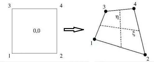

Let $(1,2,3,4)$ be the numbering of vertices in common Cartesian coordinates $(x,y)$. For a triangle we define local (so-called isoparametric) coordinates $(\xi,\eta)$ as: $$ \Delta = (x_2-x_1)(y_3-y_1)-(x_3-x_1)(y_2-y_1) \\ \xi = [(y_3-y_1)(x-x_1)-(x_3-x_1)(y-y_1)]/\Delta \\ \eta = [(x_2-x_1)(y-y_1)-(y_2-y_1)(x-x_1)]/\Delta $$ And the Inside-Outside function as: $$ \operatorname{IO}(x,y) = \min(\xi,\eta,1-\xi-\eta) $$ Then we have that a pont $(x,y)$ is inside the triangle if $\,\operatorname{IO}(x,y)\gt 0\,$, it is outside the triangle if $\,\operatorname{IO}(x,y)\lt 0\,$ and it is on the boundary if $\,\operatorname{IO}(x,y) = 0\,$.
More information and a useful application is found at:
From the following reference we have the details below.
Analogously to a triangle we have for the quadrilateral, in local / isoparametric coordinates $(\xi,\eta)$: $$ N_1(\xi,\eta) = \frac{1}{4}(1-\xi)(1-\eta) = \frac{1}{4}(1-\xi-\eta+\xi\eta)\\ N_2(\xi,\eta) = \frac{1}{4}(1+\xi)(1-\eta) = \frac{1}{4}(1+\xi-\eta-\xi\eta)\\ N_3(\xi,\eta) = \frac{1}{4}(1-\xi)(1+\eta) = \frac{1}{4}(1-\xi+\eta-\xi\eta)\\ N_4(\xi,\eta) = \frac{1}{4}(1+\xi)(1+\eta) = \frac{1}{4}(1+\xi+\eta+\xi\eta) $$ The global (common Cartesian) coordinates $(x,y)$ are calculated herefrom: $$ \begin{cases} x = N_1(\xi,\eta)x_1 + N_2(\xi,\eta)x_2 + N_3(\xi,\eta)x_3 + N_4(\xi,\eta)x_4 \\ y = N_1(\xi,\eta)y_1 + N_2(\xi,\eta)y_2 + N_3(\xi,\eta)y_3 + N_4(\xi,\eta)y_4 \end{cases} $$ It is trivial that the vertices are given by: $$ (\xi,\eta)=(-1,-1) \;\rightarrow\; (x,y)=(x_1,y_1) \\ (\xi,\eta)=(+1,-1) \;\rightarrow\; (x,y)=(x_2,y_2) \\ (\xi,\eta)=(-1,+1) \;\rightarrow\; (x,y)=(x_3,y_3) \\ (\xi,\eta)=(+1,+1) \;\rightarrow\; (x,y)=(x_4,y_4) $$ Using abbreviations $(A,B,C,D)$ may be helpful. $$ \begin{cases} x = A_x + B_x\xi + C_x\eta + D_x\xi\eta \\ y = A_y + B_y\xi + C_y\eta + D_y\xi\eta \end{cases} $$ It's easy to see that the constants are given by: $$ A_x = \frac{1}{4}(+x_1+x_2+x_3+x_4) \quad ; \quad A_y = \frac{1}{4}(+y_1+y_2+y_3+y_4) \\ B_x = \frac{1}{4}(-x_1+x_2-x_3+x_4) \quad ; \quad B_y = \frac{1}{4}(-y_1+y_2-y_3+y_4) \\ C_x = \frac{1}{4}(-x_1-x_2+x_3+x_4) \quad ; \quad C_y = \frac{1}{4}(-y_1-y_2+y_3+y_4) \\ D_x = \frac{1}{4}(+x_1-x_2-x_3+x_4) \quad ; \quad D_y = \frac{1}{4}(+y_1-y_2-y_3+y_4) $$ In general, calculating the local coordinates from the global ones is a highly non-trivial exercise. But it seems that we are lucky: the rectangle in the question is a parallelogram. In that case, Wikipedia teaches us that The diagonals bisect each other: $$ \frac{1}{2} \left(\begin{bmatrix} x_1 \\ y_1 \end{bmatrix} + \begin{bmatrix} x_4 \\ y_4 \end{bmatrix}\right) = \frac{1}{2} \left(\begin{bmatrix} x_2 \\ y_3 \end{bmatrix} + \begin{bmatrix} x_2 \\ y_3 \end{bmatrix}\right) $$ Consequently, for a parallelogram, the non-linear $\,\xi\eta\,$ factors drop out. So our equations become: $$ \begin{cases} B_x\xi + C_x\eta = x-A_x \\ B_y\xi + C_y\eta = y-A_y \end{cases} $$ Two linear equations in two unknowns which can be easily solved with Cramer's rule: $$ \xi = \frac{B_x(y-A_y)-B_y(x-A_x)}{B_xC_y-B_yC_x} \\ \eta = \frac{C_y(x-A_x)-C_x(y-A_y)}{C_yB_x-C_xB_y} $$ Now the Inside-Outside function for a general quadrilateral may be defined as: $$ \operatorname{IO}(x,y) = \min\left[N_1(\xi,\eta),N_2(\xi,\eta),N_3(\xi,\eta),N_4(\xi,\eta)\right] $$ Then we have that a point $(x,y)$ is inside the quadrilateral if $\,\operatorname{IO}(x,y)\gt 0\,$, it is outside the quadrilateral if $\,\operatorname{IO}(x,y)\lt 0\,$ and it is on the boundary if $\,\operatorname{IO}(x,y) = 0\,$. The calculations are quite feasible only for parallelograms. Summarizing the recipe:
  1. Calculate $(A_x,B_x,C_x)$ and $(A_y,B_y,C_y)$ from the vertex coordinates
  2. Calculate $(\xi,\eta)$ from $(x,y)$ with the above Cramer's solution
  3. Calculate the four shape functions $N_k(\xi,\eta) = (1\pm\xi)(1\pm\eta)/4$
  4. Calculate the Inside-Outside function as the minimum of them
