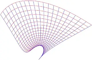

You're correct that drawing the graph of a complex-valued function of one complex variable entails four-dimensional plotting. Drawing the image of a Cartesian grid, however, is perfectly feasible in the plane:
A complex-differentiable map A smooth, non-holomorphic map
Each map above is defined by a pair of real cubic polynomials; the red curves are the images of vertical lines; the blue curves are images of horizontal lines. The maps differ in the sign of one component of the cubic term. One map is complex differentiable (or holomorphic), one is not.
The holomorphic map sends a square grid to an "infinitesimally square grid". (There is one critical point, whose image is visually apparent.) The derivative $f'(z_{0})$ at a point determines the size of the image (quasi-)square and the angle of rotation compared to the original Cartesian square.
The non-holomorphic map sends a square grid to a grid of curvilinear parallelograms that are not generally squares. This is the geometric manifestation of the directional derivatives at $z_{0}$ depending on the direction of approach to $z_{0}$: The Cartesian grid in the domain "gets stretched and rotated by differing amounts in different directions at a single point."
