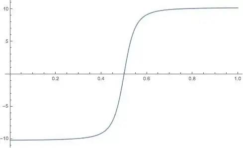

Suppose $p\in[0,1]$ is the probability that the coin lands heads up. Let $q\in[0,1]$ be the probability that a candidate successfully lands heads. Then, the skill ratio is given by $\chi_q:=\frac{q-p}{1-p}$. The candidate throws the coin $N$ times and successfully lands heads $M$ times out of $N$. We use the following estimator $\hat{q}:=\frac{M}{N}$ of $q$, assuming that $q$ is uniformly distributed on $[0,1]$. (The last assumption is the most dubious one. It may be better to assume that $q$ is uniformly distributed on $[p,1]$. However, I do not want to deal with difficult calculations.)
Assume that the measurement yields $\hat{q}=\hat{r}$ for some $\hat{r}\in[0,1]$. Therefore, we need to calculate $$\text{E}\Big(\chi_q\,\Big|\,\hat{q}=\hat{r}\Big)=\int_{0}^1\,\left(\frac{r-p}{1-p}\right)\,f(r,\hat{r})\,\text{d}r\,,$$ where $$f\left(r,\hat{r}\right):=\binom{N}{\hat{r}N}r^{\hat{r}N}(1-r)^{\left(1-\hat{r}\right)N}$$ for all $r\in[0,1]$ and $\hat{r}\in\left\{0,\frac{1}{N},\frac{2}{N},\ldots,\frac{N-1}{N},1\right\}$. This means $$\text{E}\Big(\chi_q\,\Big|\,\hat{q}=\hat{r}\Big)=\frac{1}{1-p}\,\binom{N}{\hat{r}N}\,\left(\frac{\big(\hat{r}N+1\big)!\,\big((1-\hat{r})N\big)!}{(N+2)!}-p\,\left(\frac{\left(\hat{r}N\right)!\,\big((1-\hat{r})N\big)!}{(N+1)!}\right)\right)\,.$$ That is, $$\mu:=\text{E}\Big(\chi_q\,\Big|\,\hat{q}=\hat{r}\Big)=\frac{\left(\hat{r}-p\right)N+1-2p}{(N+1)(N+2)(1-p)}\,.$$ For $p=\frac{1}{2}$, we get $$\mu=\frac{\left(2\hat{r}-1\right)N}{(N+1)(N+2)}\,.$$
Now, $$\text{E}\Big(\chi_q^2\,\big|\,\hat{q}=\hat{r}\Big)=\,\int_0^1\,\left(\frac{r-p}{1-p}\right)^2\,f\left(r,\hat{r}\right)\,\text{d}r\,,$$ or $$\text{E}\Big(\chi_q^2\,\big|\,\hat{q}=\hat{r}\Big)=\frac{\left(\hat{r}-p\right)^2N^2+\left(3\hat{r}(1-2p)-2p+5p^2\right)+\left(2-6p+6p^2\right)}{(N+1)(N+2)(N+3)(1-p)^2}\,.$$ Ergo, $$ \begin{align}\sigma:=\sqrt{\text{Var}\Big(\chi_q^2\,\big|\,\hat{q} =\hat{r}\Big)}=\frac{\sqrt{\tau}}{(N+1)(N+2)\sqrt{N+3}(1-p)}\,,\end{align}$$ where $$ \begin{align}\tau&:=(\hat{r}-p)^2N^4+\left(2\hat{r}^2+(3-10)p\hat{r}-2p+7p^2\right)N^3 \\&\phantom{abcdef}-\left(\hat{r}^2+(7-12p)\hat{r}+2-10p+16p^2\right)N^2+\left(5-12p+12p^2\right)N+1\,. \end{align}$$ If $p=\frac{1}{2}$, we have $$\sigma=\frac{\sqrt{(2\hat{r}-1)^2N^4+\left(8\hat{r}^2-8\hat{r}+3\right)N^3-\left(\hat{r}^2-\hat{r}-1\right)N^2+8N+4}}{(N+1)(N+2)\sqrt{N+3}}\,.$$
If the estimated skill ratio is $\hat{\chi}=\frac{\hat{r}-p}{1-p}$, then the skillfulness can be defined by $$\hat{S}:=\frac{\hat{\chi}-\mu}{\sigma}\,.$$ Fix $p=\frac{1}{2}$.
(1) When $N=10^2$ and $\hat{r}=1$, then $\hat{S}\approx 10.2$.
(2) When $N=10^4$ and $\hat{r}=\frac{9}{10}$, then $\hat{S}\approx 100.02$.
(3) When $N=10^6$ and $\hat{r}=\frac{8}{10}$, then $\hat{S}\approx 1000$.
(4) When $N=10^9$ and $\hat{r}=\frac{7}{10}$, then $\hat{S}\approx 31623$.
(5) When $N=10^{10}$ and $\hat{r}=\frac{6}{10}$, then $\hat{S}\approx 100000$.
It seems like $\hat{S}$ goes to $\sqrt{N}$ very quickly when $\hat{r}$ starts to exceed $p$. See the plot of $\hat{S}$ versus $\hat{r}$ for $p=\frac{1}{2}$ and $N=100$ below.

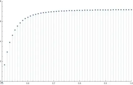

As mentioned in the first paragraph, it should be better if $q$ is assumed to be uniformly distributed on $[p,1]$. Here are some calculations with the modified distribution of $q$ under $p=\frac{1}{2}$:
(1) $N=10^2$ and $\hat{r}=1$ yield $\hat{S}\approx 7.178$;
(2) $N=10^4$ and $\hat{r}=\frac{9}{10}$ yield $\hat{S}\approx 70.79$;
(3) $N=10^6$ and $\hat{r}=\frac{8}{10}$ yield $\hat{S}\approx 707.1$;
(4) $N=10^{9}$ and $\hat{r}=\frac{7}{10}$ yield $\hat{S}\approx 22361$;
(5) $N=10^{10}$ and $\hat{r}=\frac{6}{10}$ yield $\hat{S}\approx 70711$.

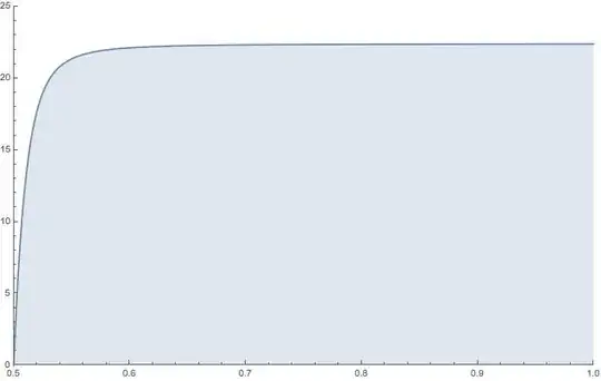

Note that $\hat{S}$ goes to $\sqrt{\frac{N}{2}}$ very quickly. See the plots of $\hat{S}$ against $\hat{r}$ for $p=\frac{1}{2}$ and $N=100$ (on top) as well as $N=1000$ (at the bottom) below.

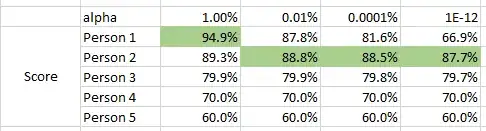

I think a good way to organize such a contest would be to request people to show the highest Lower bound of confidence interval for a Bernoulli parameter, as suggested here.
In nearly plain english, is to define some (very low) confidence level alpha, and to set the score of each person that participated as "The lowest possible actual probability of success of the coinflipper that would have given such a good record with a probability higher than alpha"
I like this solution because any contestant will eventually converge towards it's actual success rate, but will very rarely (with a small probability of your choosing) be above during its convergence process. Thus any contestant patient enough can hope to overcome any opponent in the end, knowing that this opponent is very unlikely to have been ranked to high out of luck.
Let's choose alpha as 0.01%
This method enables us to select a winner for your contest : Person 2 wins !! with a score of 88.8%
Note that with a p-value of 1%, Person 1 wins, and that my poor Excel overflows before I reach a probability that will make person 3 wins, probably around the event of a 27 sigma variation in a normal distribution.
Score of different people with different confidence level
My solution is not perfect, because as small as I can chose my alpha, there is always the possibility that some contestant gets lucky enough to get a lower-bound estimate too generous, which would allow him an advantage that could not be overcome by other contestants that can only hope to converge towards their true success rate. Depending on the hypothesis you are ready to take, and what you want to achieve, you will choose one or the other
