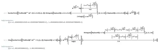

This equation, with $x=e^{it}$ is equivalent to solving: $$\operatorname{Re}\big(e^{e^{i t}}\big)=e^{\cos(t)}\cos(\sin(t))=\frac a2$$ Contrary to other users, there is an analytic solution for both positive branches via Lagrange reversion solutions being $(x,a^{\pm 1})$. Finding $x=\sum\limits_{n=1}^\infty a_n$ requires finding $\frac{d^{n-1}}{dw^{n-1}}\frac1we^\frac n{\ln(w)}$, so instead: $$e^x+\sqrt[x]e=a\iff e^{\pm x}=a+\sum_{n=1}^\infty\frac{(-1)^n}{n!}\left.\frac{d^{n-1}}{dw^{n-1}}e^\frac n{\ln(w)}\right|_a$$ A Maclaurin series and Stirling S1 $\frac{d^n}{dx^n}\ln^a(x)$ formula give: $$\frac{d^{n-1}}{dw^{n-1}}e^\frac n{\ln(w)}=\sum_{m=0}^\infty\frac{n^m}{m!}\frac{d^{n-1}}{dw^{n-1}}\ln^{-m}(w)=\sum_{m=0}^\infty\sum_{k=0}^{n-1}\frac{(-1)^kn^mS_{n-1}^{(k)}\Gamma(k+m)}{\ln^{m+k}(w)w^{n-1}\Gamma(m)m!}$$ The $m$ sum is the confluent hypergeometric function. Therefore: $$\bbox[4px,border: 4.5px groove #87CEFA ]{e^x+\sqrt[x]e=a\implies x^{\pm1}=\ln\left(a-1+\sum_{n=1}^\infty\sum_{k=0}^{n-1}\frac{S_{n-1}^{(k)}(-1)^{k+n}k!}{\ln^{k+1}(a)a^{n-1}\Gamma(n)} \,_1\text F_1\left(k+1;2;\frac n{\ln(a)}\right)\right)}$$ Shown here.
To find integral representations, one can use $_1\text F_1$’s functional identity, convert it into a Laguerre polynomial, switch the series with $\operatorname L_{n-1}^1(w)$’s integral representation, and finally Stirling S1’s generating function, but the solution would be a logarithm of an integral. Instead, one can find a direct integral representation after expanding: $$e^x+e^\frac1x=a\implies x^{\pm1}=\ln(a)+\sum_{n=1}^\infty\frac{(-1)^n}{n!}\frac{d^{n-1}}{da^{n-1}}\ln’(a)e^{-\frac1{\ln(a)}}$$ Evaluating the derivatives like in the first part of the post gives a triple sum, but applying the above integral representation steps and integration by parts with limits at integrand discontinuities, like here, gives: $$\begin{align}\bbox[4px,border: 4.5px groove #87CEFA ]{ e^x+e^\frac1x=a\implies x^{\pm1}=\ln\left(a-e^\frac1{\ln(a)}\right)+\frac1{2\pi}\int_0^{2\pi}\frac{e^{it}}{ae^{-\frac{e^{it}+1}{\ln(a)}}-1}\log_a\left((e^{-i t}+1)\log_a\left(1-\frac1a e^\frac{e^{it}+1}{\ln(a)}\right)+1\right)dt\\=\ln\left(\left(a-e^\frac1{\ln(a)}\right)\left(2\log_a\left(1-\frac1ae^\frac1{\ln(a)}\right)+1\right)\right)+\int_0^{2\pi}\frac{\log_a\left(e^\frac{e^{it}+1}{\ln(a)}-a\right)\left((e^{it}+1) e^{\frac{e^{it}+1}{\ln(a)}+it}-\ln(a)\left(e^\frac{e^{it}+1}{\ln(a)}-a\right)\ln\left(1-\frac1a e^\frac{e^{it}+1}{\ln(a)}\right)\right)}{\left(e^\frac{e^{it}+1}{\ln(a)}-a\right)\left((e^{it}+1)\ln\left(1-\frac1a e^\frac{e^{it}+1}{\ln(a)}\right)+e^{it}\ln(a)\right)}dt}\end{align}$$
shown here: enter image description here
Тyma Gaidash
