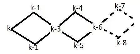

Here is the best Solution I found when I was preparing for IIT-JEE 2000-2003. suppose equation is $x + y +z + t = N$ find $k= [(N-2n-4)/2]$, where n is the least integer present is the solution. for example to find number of solutions in which least number present is $1$, put $n=1$. Now draw the following diagram enter image description here Stop when $1$ comes. Now If $N$ is even add lower row terms along with middle row terms and multiply the sum with $4!$. This is the number of unequal integral solution of above equation having n as the least integer. If $N$ is odd add upper row terms along with middle row terms and multiply the sum with $4!$. Repeat the process for other possible values of $N$. In above case $n$ can have values $0, 1, 2$, & $3$, if we are interested in finding non-negative unequal integral solutions, because $4 + 5 + 6 + 7 > 20$ for $n=0$, there are $24\times 4!$ solution for $n=1$, there are $14\times 4!$ solutions for $n=2$, there are $7\times 4!$ solutions and for $n=3$, there are $2\times 4!$ solutions. Total number of non-negative solutions can be obtained by adding all$= 1128$ If you are interested in only positive unequal integral solutions drop the case of n=0, and you get $552$ If you wish to obtain solution for $x, y, z, t > 1$, drop the case $n=0$ and $n=1$ both, and you get $216$. and so on.......
