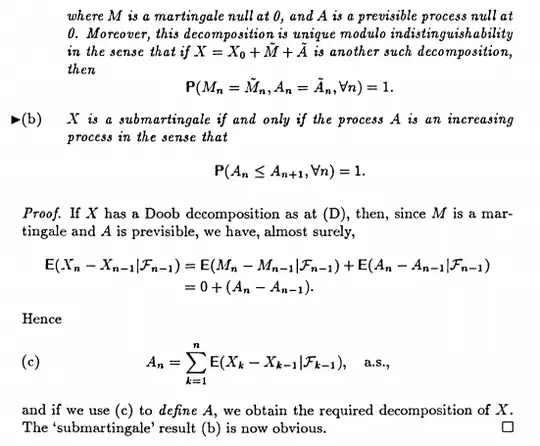

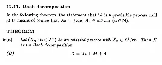

To prove $b$ I tried:
$$A_n \ge A_{n-1}$$
$$\iff E[X_{n} - X_{n-1} | \mathscr F_{n-1}] \ge 0$$
$$\iff E[X_{n} | \mathscr F_{n-1}] \ge X_{n-1}$$
That suffices to show 'if' but what about 'only if'?
I think I can conclude that $P(A_n \ge A_{n+1}) = 1 \ \forall n$, but how do I conclude $P(A_n \le A_{n+1} \ \forall n$) = 1? I think I need right continuity or something? I remember indistinguishable vs modification being discussed in classes, but I think it wasn't discussed at this point in the book.
BCLC
  • 14,197
This is discrete time, so right continuity is not an issue. It is simply the fact that if $P[D_n]=1$ for all $n$ then $P\left[\cap_n D_n\right]=1$ (and conversely).
John Dawkins
  • 29,845
  • 23
  • 39
  • John Dawkins, do we really have that $$P(\bigcap_{n=1}^{\infty} D_n) = 1 \iff P(D_n) = 1 \ \forall n \ge 1$$? I mean, 'only if' follows by monotonicity of probability but what about 'if' ? – BCLC Jun 11 '16 at 16:58
    @BCLC to see why this is true, try to prove the complement has measure probability – clark Jun 11 '16 at 17:18
    @BCLC, see Proposition 2.4(a) on page 25 of Probability with Martingales. – John Dawkins Jun 11 '16 at 17:50
  • @JohnDawkins Thanks! ^-^ – BCLC Jun 11 '16 at 18:15
