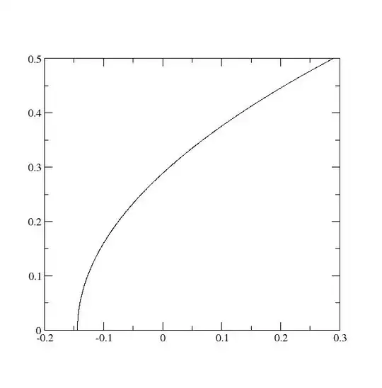

For the case I mention above (the man and the lions have same speed, otherwise the answer is obvious), let us pick the person in the centre of the triangle and running towards the middle of one side, and the lion just above him starting to run towards the person with same speed. Using a reference frame in which the man is still, and complex numbers to describe the lion position, one can write for $z=\rho e^{I \phi}$: $$\dot z = -v e^{I \phi} -v$$ (where $v$ is the speed). We can rescale distances in units of the side of the triangle $L$ and time in units of $L/v$, to get the dimensionless $$\dot z=-1-e^{I \phi}$$, from where: $$\dot \rho =-(1+\cos \phi) \\ \rho \dot \phi =\sin \phi.$$
The solution to this equations are: $$\rho = \rho_0 ( \frac{\sin\frac{\phi}{2}}{\sin\frac{\phi_0}{2}} )^2$$ and $$\log\tan^2\frac{\phi}{2}-\frac{1}{\sin^2\frac{\phi}{2}} \Bigg\vert_{\phi_0}^{\phi}=\frac{2t}{\rho_0 \sin^2\frac{\phi_0}{2}},$$ where $t$ is the time (starting from $0$), $\rho_0=1/\sqrt 3$, and $\phi_0=\pi/3$.
Note from the last equation, that we need to solve for $\phi =\phi(t)$. This is possible if we notice that $\sin^2$ can be expressed as function of $\tan^2$ and we solve for $\tan$ using the Lambert W-function. With it, we can obtain $\rho=\rho(t)$ from the above solution $\rho=\rho(\phi)$.
The solution obtained using the above and validated by integrating the complex ODE equation with the Runge-Kutta method of order $4$ give for the trajectory of the lion (remember that the man sits still at the origin of the complex plane): enter image description here
The lion as seen by the running man, starts in the upper right corner. Remember that the units of length are in units of the side of the triangle, so if the triangle is too small, the lion even if it does not reach the origin (where the person is in his reference frame), could still grab him if in close range.
