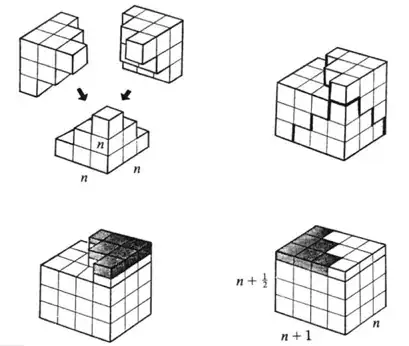

I like visual proofs. In the following, the first three shapes pile together $1^1$, $2^2$, $3^2$, $4^2$ little cubes:
visual sum of squares
with similar visions in:
  • Claudi Alsina and Roger Nelsen, When Less is More: Visualizing Basic Inequalities (2009)
  • Roger B. Nelsen, Proofs without words 2. More exercises in visual thinking (2000)
  • Roger B. Nelsen, Proofs without words. Exercises in visual thinking (1993)
which I discuss in Unconventional mathematics books.
The three same basic shapes, sums of squares, add up to $n(n+1)(n+\frac{1}{2})$, hence the volume (a third) you are looking for is : $$\frac{n(n+1)(2n+1)}{6}\,.$$
Last comment: $\int x^p \sim \frac{x^{p+1}}{p+1}$, hence integration "adds" a degree. The case $p=-1$ is a bit different, but I'd argue the $\log$ is dimensionless, i.e. a variant of $0$-degree polynomials. Similarly, summing $p$-powers often leads to $p+1$-power formulae.
