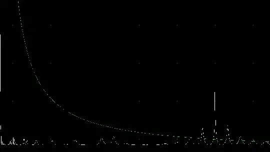

So I have this apparently smooth, parametrized function:
The function has a single parameter $ m $ and approaches infinity at every $x$ that divides $m$.
It is then defined for real $x$ apart from a finite set of arguments. The animation above shows plots of $f_{m}(x)$ (in white) for $x\in(0, 17>$, while each frame shifts $m$ by $0.05$ starting from $2$ and ending in $17$. In green plotted is a hyperbola $(x, {m\over x})$.

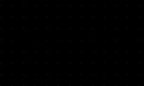

Consider a lattice of integer-valued points $(a, b)$:
(the origin $(0, 0)$ is at the left-bottom corner of the picture)

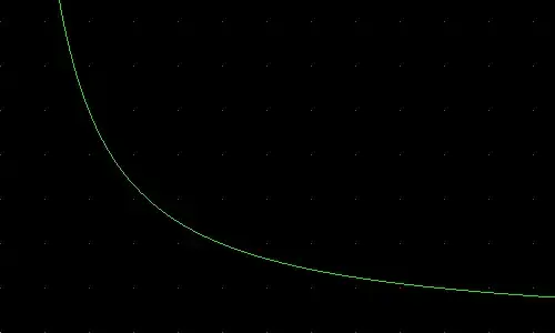

Let us draw a hyperbola $(x, {m\over x})$ for real $x$ and for $m = 10$.
It is trivial to observe that intersections of the hyperbola and the lattice lead us to factors of $m$, in this case, $10$. For example, the green curve above intersects red dots at $(2, 5)$ and $(5, 2)$.

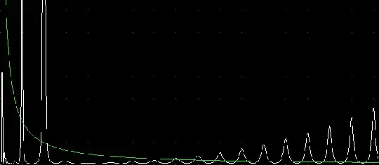

Plot of $f_{11}(x), x > 0$:
Notably, the function only ever approaches infinity at $x\in \{0, 1, 11\}$ ultimately indicating primality of $11$.

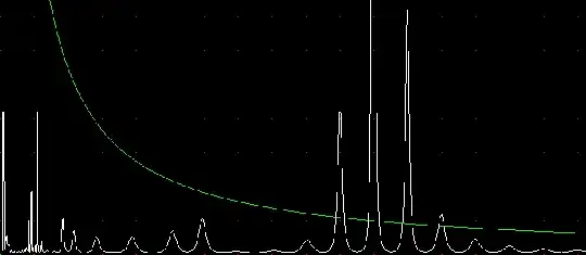

In fact, the plots look almost identical. Consider $f_{17}(x):$
For me, it appears to yield a perfectly acceptable estimate.
I believe it is especially worthy of our attention that the function looks like it remains smooth even in presence of floor function.
