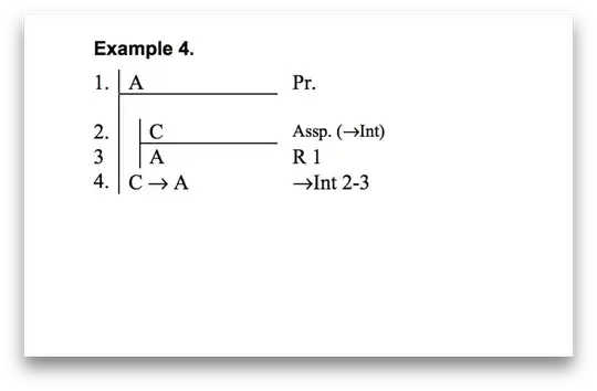

Apparently, according to the Conditional Introduction rule, this is valid: Prove $C \to A$ enter image description here
Source: http://kpaprzycka.wdfiles.com/local--files/logic/W12R Page 5
So before this, the way I viewed the CI rule, was that it allowed us to prove that if we assume the antecedent is true, we can prove the consequent can derived from the antecedent, by referring to the premises which lead to the consequent. If later we find that the antecedent is true, then we can conclude what we already done so before when we just assumed. So basically, sub derivations are inactive at first, but activated if the assumption of said sub derivation is confirmed.
In this example, it's basically stating that the mere assumption of some proposition is enough to state that it applies to some other already proven proposition. It's like you might as well skipped over the sub derivation and said, 'Given $A, C \to A$ because I want it to'.
Personally, I think this is a mistake, though if not, I can't see how you could justify that $C \to A$ given $A$ and assuming $C$ is true alone.

  • That last "given that C is true alone" was a typo for "given that A is true alone"? Yes, this is perfectly valid. Why shouldn't it be? Suppose it's raining. Given that it's raining, the sentence "If it's Tuesday it's raining" is certainly true. – David C. Ullrich May 29 '16 at 15:46
  • "Personally, I think this is a mistake, though if not, I can't see how you could justify that $C\to A$ given that $C$ is true alone." You can't justify this because it's not true, and you've given some indication that you understand this. What you proved was $A\vdash C\to A$. – Git Gud May 29 '16 at 15:46

  • @DavidC.Ullrich no not a typo, the 'proof' was assuming C, to conclude A, thus C -> A. We already knew A was true as it was stated as a proposition. – user2901512 May 29 '16 at 15:55

  • Whatever - then the last sentence is simply wrong. We did not infer C->A assuming C alone. In fact we did not infer C->A assuming C! We inferred A assuming C. One cannot infer C->A assuming C alone - luckily that didn't happen. – David C. Ullrich May 29 '16 at 15:58

4 Answers4
In Natural Deduction, it is correct
given $A$, to derive $C \to A$.
See:
Consider as another case $A ⊃ (B ⊃ A)$.
Verbally, if we assume $A$, then $A$ follows under any other assumption $B$:
  1. $A$ --- hypothesis: goal $B ⊃ A$
  2. $B ⊃ A$ --- 1,$⊃$I
  3. $A ⊃ (B ⊃ A)$ --- 1–2,$⊃$I
This does not look particularly nice: we have closed an assumption $B$ that was not made. But if we say that an assumption was used $0$ times, the thing starts looking more reasonable.

  • Wait... when you say 'used 0 times', do you mean that the conclusions drawn from said assumption cannot be validated and thus used until the assumption is validated? – user2901512 May 29 '16 at 16:21

Maybe a bit simpler, using another form of natural deduction...
-1
So, I can prove it without the rule of repetition as follows.
1 hypothesis   | A
2 1-1 -> Int    (A -> A)
3 assumption   | A
4 hypothesis   || C
5 2, 3 -> Elim || A
6 4-5 -> Int   | (C -> A)
Note that in the derivation of 2, I assumed the antecedent A as true, the consequent A got proved from the antecedent A, by referring to the premise A which lead to the consequent A. In this way, the repetition rule could get proved as a derivable rule of inference.
