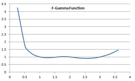

Now we formally extend $t$ from $N \gt 0$ to $t \in C$. Using this, I can construct (perhaps the first?!) table of "F-Gamma" values using $n!_F=\mathfrak F(n+1)$,
$$ \begin{array}{c|lcr} n & \mathfrak F(n) & \ln(\mathfrak F(n))\\ \hline 1 & 1 & 0\\ 1.1 & 0.966975 & -0.033582\\ 1.2 & 0.951630 & -0.049579\\ 1.3 & 0.951521 & -0.049692\\ 1.4 & 0.963404 & -0.037283\\ 1.5 & 0.982610 & -0.017543\\ 1.6 & 1.003127 & 0.003122\\ 1.7 & 1.018567 & 0.018396\\ 1.8 & 1.023911 & 0.023630\\ 1.9 & 1.017193 & 0.017048\\ 2.0 & 1 & 0\\ \end{array} $$
Here's a graph (I didn't say it'd be pretty ;))
Check the recurrence, defined in $(1)$. It works!!!
