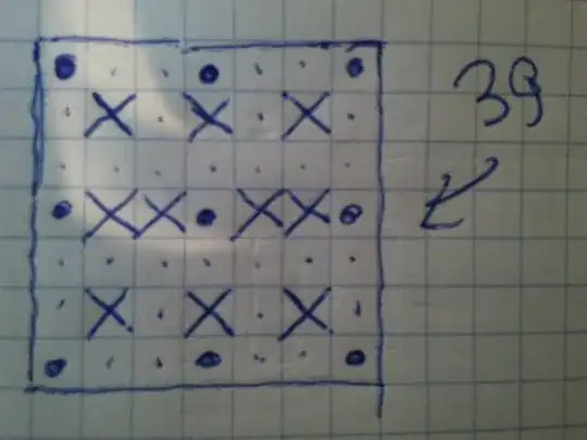

  • @alexis forgot about it on 7x7 matrix. Here's 39 respecting the 9 Sudoku blocks. Bold dots are Sudoku blocks http://i.imgur.com/BwApqkN.jpg – rfg May 22 '16 at 16:50
  • Nice! Now if you could somehow put together a Sudoku with this arrangement, you've established $N_{max} \ge 39$, which (together with my answer) means it is 39. :-). But there might well be other constraints too, that make this arrangement impossible... – alexis May 22 '16 at 17:29
