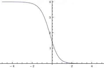

I have a second order differential equation, \begin{eqnarray} \dfrac{d^2 y}{d x^2} = H\left(x\right) \hspace{0.05ex}y \label{*}\tag{*} \end{eqnarray}
where, $\,H\left(x\right) = \dfrac{\mathop{\rm sech}\nolimits\left(x\right) \mathop{\rm sech}\nolimits\left(x\right)}{x + \ln\big(2\cosh\left(x\right)\big)}$. Plot of function $\,H\left(x\right) $ is shown below: enter image description here
I need to find solution of the equation $\eqref{*}$ for the boundary conditions

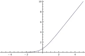

Obvious solution of the problem is $\,y=0$. But $\,y = x + \ln\big(2 \cosh\left(x\right)\big)\,$ also satisfies differential equation $\eqref{*}$, and satisfies boundary conditions $\eqref{**}$. Plot of $y\left(x\right)$ is shown below: enter image description here
As far as I know there cannot be two solution of the differential equation satisfying given boundary conditions. What am I missing here? Is uniqueness theorem not valid if the boundary conditions are applied at $\,\pm\infty$.
