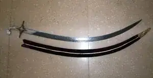

A sword can be made in any shape at all, but if you want to be able to put it into a scabbard, only certain shapes will do. For simplicity, let us neglect the width of the sword, and take it to be the image of a continuous mapping $[0,1]\to {\Bbb R}^3$. Clearly, a sword in the shape of a circular arc will fit into a similar scabbard, as long as the arc is less than about half of a full circle:
shamshir
(For non-mathematical reasons, such swords are rarely more than about $\frac1{36}$ of circle.)

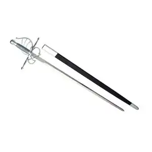

If we let the curvature go to zero, we get the special case of a straight segment, which can be of any length:
rapier
