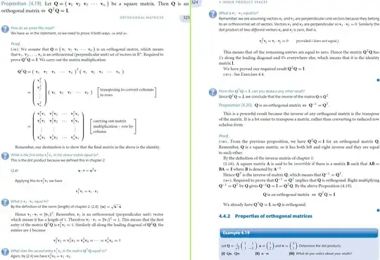

Kuldeep Singh's Linear Algebra: Step by Step (2013) pp 322-324 details this more than answers here. I don't affiliate Kuldeep Singh.
