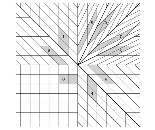

I claim that we must know, in some way, the cases $(1)$--$(9)$ if we want to have a full an clear understanding of the $9$-periodic behavior of the sequence $(a_n)\,$: the nine cases are at the heart of the $9$-periodicity, they comprise its structure.
Denote by $T$ the mapping $\mathbb{R}^2\to\mathbb{R}^2$ that we have introduced above: $T(x,y) = (y,\,\left|y\right|\!-\!x)$. Then $T(a_{n-1},a_n)=(a_n,a_{n+1})$, which is precisely the reason why we introduced the transformation $T$. The fact that the sequence $(a_n)$ can be recurrently produced backwards means that the transformation $T$ is invertible; and indeed, $T^{-1}(x,y) = (\left|x\right|\!-\!y,\,x)$.
The part of the plane $\mathbb{R}^2$ corresponding to the case $(1)$ is the lower-left quadrant (the third quadrant), denote it by $Q$. Now look at the parts $T^k Q$, $0\leq k\leq 8\,$:
The nine parts of the plane corresponding to the cases $(1)$--$(9)$. (The enumeration is by $k$ in $T^k Q$, not by the ad hoc case number. You may enjoy identifying the cases correponding to the $T^k Q$.)$\,$ The transformation $T$ appears as a highly uneven piecewise-linear attempt at realizing the idea "rotate clockwise by two ninths of the full turn". And with the figure in front of our noses we clearly see that $T^9$ is the identity transformation of the plane $\mathbb{R}^2$, which expresses in one breath the $9$-periodicity of all possible sequences $(a_n)$ generated by the given recurrence relation.

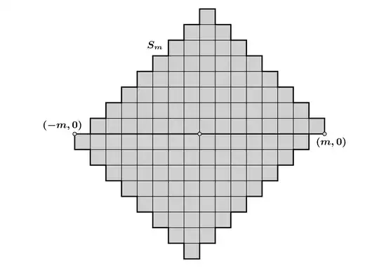

It would be an extremely dull problem that could not inspire more problems. The recurrence given in the present question is not of the dull kind, it has an interesting cousin: \begin{equation*} a_{n+1} \,=\, \mathrm{sgn}(a_n) - a_{n-1}~, \qquad n\in\mathbb{Z}\,. \end{equation*} (The $\mathrm{sgn}(x)$ is the sign of a real number $x$: it is $1$ if $x>0$, it is $0$ if $x=0$, and it is $-1$ if $x<0$.) Like the original recurrence, this recurrence works also backwards: $a_{n-1}=\mathrm{sgn}(a_n)-a_{n+1}$. And like the original recurrence, each and every sequence $(a_n)$ it produces is periodic; the difference is that there is no common period, because there exist sequences that have arbitrarily large periods. So solving this recurrence offers much more fun. Another difference is that this time we do have a simple explanation of periodicity. Here's a hint. Define the transformation $U\colon\mathbb{R}^2\to\mathbb{R}^2$ by $U(x,y):=(y,\,\mathrm{sgn}(y)\!-\!x)$. Then for every integer $m\geq 1$ the transformation $U$ induces a bijection $U_m\colon S_m\to S_m$, where $S_m$ is the (closed) set The set $S_m$ The bijection $U_m$ is not continuous, it has a discontinuity along the line segment $L_m$ with endpoints $(-m,0)$ and $(m,0)$. However, the restrictions of $U_m$ to the line segment $L_m$ as well as to each of the two connected components of $S_m\setminus L_m$ are isometries. The bijection $U_m$ induces permutations of $2$-cells in $S_m$ (the open unit squares), of $1$-cells (the open unit line segments, the sides of the squares), and of $0$-cells (the points, the vertices of the squares); this implies finite periods. You may enjoy determining the periods of sequences $(a_n)$ generated by particular points $(a_0,a_1)\in\mathbb{R}^2$.
