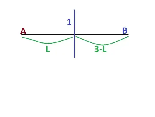

The Linear Solution
Referencing the above diagram, we see that this essentially non-deterministic problem, has a very deterministic property associated with it. Namely, after the wall encounter, the rest of the optimal path can be determined. However, the optimal path before the wall encounter is indeterminate. In other words, we can only know what path we should've taken; we can't actually take that path.
Imagine we have some optimal strategy that picks an optimal path $f(x)$. Since the problem has no memory, the optimal path is unique. In addition, this memory property rules out the possibility of a mixed strategy solution.
Putting these facts together, we see that $f(x)$ is deterministic for $x \lt L$ and random for $x \gt L$. However, some things about $f(x)$ are known,
$$(a) \quad f(0)=0$$ $$(b) \quad \lim_{x \to L^+} f(x)=1$$ $$(c) \quad f(3)=0$$ $$(d) \quad f(x) \le 1$$
If we now consider all possible paths $p(x)$ satisfying the conditions (a-d) we can investigate the path $p_m(x)$ that minimizes the length. The length of a path $p(x)$ from $x=0$ to $x=L$ is given by,
$$L_p=\int_0^3 \sqrt{1+\left(\cfrac{dp}{dx} \right)^2} \ dx+(1-p(L)) $$
By inspection, we see that the right hand side is minimized for $p(L)$, evaluated from the left, closer to $1$. However, this means that the average slope of $p(x)$ will therefore have to be equal to $\cfrac{p(L)}{L}$. Since the shortest curve with an average slope equal to that amount is a line, we know that $p_m(x)$ must be linear*. This means we can derive an explicit formula for $L_p$ using $\cfrac{dp_m}{dx}=\lambda$. Note that if a path overshoots the wall, it can only keep going in the same direction. There's no knowledge that it over shot the wall, until the instant before it reaches point B.
If we take the expected value of $L_p$ we can find the value of $\lambda$ that minimizes the length. This value of $\lambda$ determines the slope of the optimal path. The other conditions determine $p_m(x)$ and thus $f(x)$. Note, that the resulting equations are explicit, they are just too complicated to effectively represent here. In fact, I actually didn't even solve it right on the first try! (I still might not have, i.e physical answer)
I get that $\lambda=0$ solves the problem. This gives an expected path length of,
$$E(L_p)=\cfrac{3 \cdot (\sqrt{10}+11)-\ln(\sqrt{10}-3)}{12}=3.6921$$

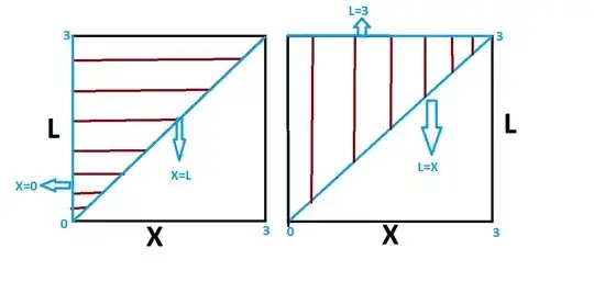

I have to thank @user5713492 for the idea to change the order of integration, here's the quick sketch of why
$$\int_0^3 \int_0^L \sqrt{1+\left(\cfrac{dp}{dx} \right)^2} \ dx dL =\int_0^3 \sqrt{1+\left(\cfrac{dp}{dx} \right)^2} \int_x^3 dL dx$$ $$=\int_0^3 (3-x) \cdot \sqrt{1+\left(\cfrac{dp}{dx} \right)^2} \ dx$$
The second double integral is much easier, and I'll leave it to the reader to verify that it can be contracted to, $3 \cdot \int_0^3 \sqrt{1+\left(\cfrac{dp}{dx} \right)^2} \ dx$. Substituting this information in and simplifying we get,

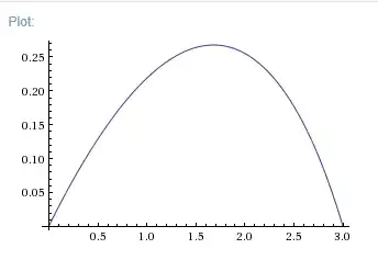

This equation can be solved by demanding $p(0)=p(3)=0$ for the boundary conditions. We can immediately integrate this equation with respect to $x$ and obtain,
$$ \cfrac{(6-x) \cdot p'(x)}{\sqrt{1+(p'(x))^2}}=-x+c_0$$
After solving for the velocity, we obtain,
$$p'(x)=-(x+c_0) \cdot \sqrt{\cfrac{1}{(c_0+6) \cdot (6-2 \cdot u-c_0)}}$$
We can directly integrate this equation and obtain the optimal path,
$$p(x)=c_1-\int (x+c_0) \cdot \sqrt{\cfrac{1}{(c_0+6) \cdot (6-2 \cdot x-c_0)}} \ dx$$
$$\Rightarrow p(x)=c_1-\cfrac{1}{3} \cdot (2 \cdot c_0+x+6) \cdot (c_0+2 \cdot x-6) \cdot \sqrt{\cfrac{1}{(c_0+6) \cdot (6-2 \cdot x-c_0)}}$$
$$p(0)=p(3)=0$$
Since we have two boundary conditions and two constants, this solution is perfectly valid. In fact we can explicitly solve for $c_0$ and $c_1$.
$$c_0=\cfrac{\sqrt{57}-21}{8}=-1.68127$$ $$c_1=-\cfrac{\sqrt{14 \cdot (\sqrt{57}+85)} \cdot (3 \cdot \sqrt{19}+49 \cdot \sqrt{3})}{2688}=-1.17247$$
The value for $E(p(x))$ for this path is and a plot is shown below. The length of the arc itself is about $3.065$. I don't want to do the integral, sorry. Luckily, @Trefox did the computation which results in a path length of $3/2 \cdot \sqrt{1/2 \cdot (31 - 3 \sqrt{57})} $
$$E(p(x))=\cfrac{\operatorname{sinh^{-1}}(3)}{12}+\cfrac{5 \cdot \sqrt{42} \cdot (3235-279) \cdot \sqrt{57})}{672}+\cfrac{\sqrt{14 \cdot (\sqrt{57}+85)} \cdot (3 \cdot \sqrt{19}+43 \cdot \sqrt{3})}{5376}+\cfrac{2+\sqrt{10}}{4}$$ $$=3.64827...$$

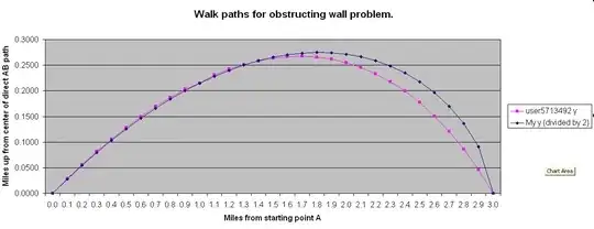

  • @Zach466920 Nice solution! One interesting feature is that it seems not to depend on what size the wall is --- the Euler-Lagrange equation doesn't include the wall size, and neither of the boundary conditions do either. Is this true? – user326210 Jan 08 '17 at 19:09
    For anyone curious, the exact length of this optimal path is 3/2 Sqrt[1/2 (31 - 3 Sqrt[57])] – Nico A Jun 03 '18 at 20:37
  • @TreFox Nice! I'll add that in! – Zach466920 Jun 05 '18 at 20:00
  • @Zach466920 In fact, the path length for any distance from A to B is that same formula but with the 3 in the numerator of the first fraction replaced with the distance. And since the answer doesn't depend on the wall height, we have a very nice general answer in the end. – Nico A Jun 05 '18 at 23:15

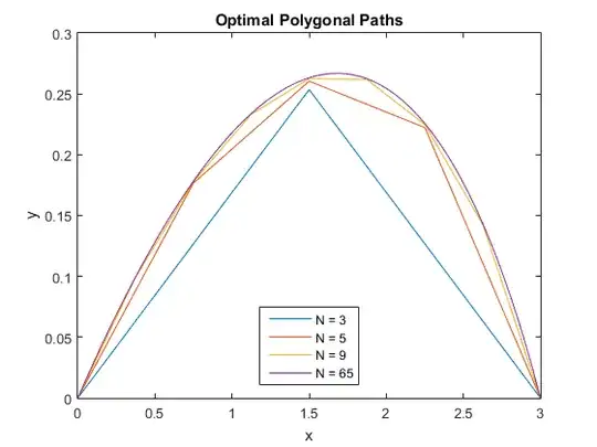

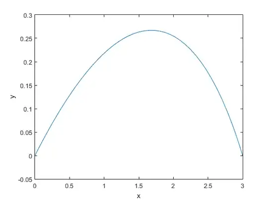

I think a have a plausible solution. If we follow the curve $y=y(x)$ on a wall day, then we travel a distance of $\int_0^u\sqrt{1+\left(y^{\prime}(x)\right)^2}dx$ before hitting the wall at $u$. Then we have to go $w-y(u)$ to go around the wall of half-width $w$, and then a further $\sqrt{w^2+(B-u)^2}$ to get to our goal at $x=B$. Assuming uniform distribution of wall placements $u$, the average distance on a wall day is $$\frac1B\int_0^B\left[\int_0^u\sqrt{1+\left(y^{\prime}(x)\right)^2}dx+w-y(u)+\sqrt{w^2+(B-u)^2}\right]du$$ On a non-wall day, our average distance is the uninterrupted path length, $$\int_0^B\sqrt{1+\left(y^{\prime}(x)\right)^2}dx=\frac1B\int_0^BB\sqrt{1+\left(y^{\prime}(u)\right)^2}du$$ Since half of the days are wall days, the average distance is $$\frac1{2B}\int_0^B\left[\int_0^u\sqrt{1+\left(y^{\prime}(x)\right)^2}+w-y(u)+\sqrt{w^2+(B-u)^2}+B\sqrt{1+\left(y^{\prime}(u)\right)^2}\right]du$$ Now, we can change the order of integration of that double integral to get $$\begin{align}\int_0^B\int_0^u\sqrt{1+\left(y^{\prime}(x)\right)^2}dx\,du&=\int_0^B\sqrt{1+\left(y^{\prime}(x)\right)^2}\int_x^Bdu\,dx\\ &=\int_0^B(B-x)\sqrt{1+\left(y^{\prime}(x)\right)^2}dx\end{align}$$ So now our average distance reads $$\bar s=\frac1{2B}\int_0^B\left[(2B-x)\sqrt{1+\left(y^{\prime}(x)\right)^2}dx+w-y(x)+\sqrt{w^2+(B-x)^2}\right]dx$$ Now we want to vary the optimal solution by a small adjustment, $\delta y$. Expanding that first square root for small $\delta y$, $$\sqrt{1+\left(y^{\prime}+\delta y^{\prime}\right)^2}\approx\sqrt{1+\left(y^{\prime}\right)^2+2y^{\prime}\delta y^{\prime}}\approx\sqrt{1+\left(y^{\prime}\right)^2}+\frac{y^{\prime}}{\sqrt{1+\left(y^{\prime}\right)^2}}\delta y^{\prime}$$ Integrating by parts, $$\begin{align}\int_0^B(2B-x)\frac{y^{\prime}}{\sqrt{1+\left(y^{\prime}\right)^2}}\delta y^{\prime}dx&=\left.(2B-x)\frac{y^{\prime}}{\sqrt{1+\left(y^{\prime}\right)^2}}\delta y\right|_0^B-\\ &\int_0^B\delta y\left\{-\frac{y^{\prime}}{\sqrt{1+\left(y^{\prime}\right)^2}}+(2B-x)\frac{y^{\prime\prime}}{\sqrt{1+\left(y^{\prime}\right)^2}}-(2B-x)\frac{\left(y^{\prime}\right)^2y^{\prime\prime}}{\left(1+\left(y^{\prime}\right)^2\right)^{\frac32}}\right\}dx\\ &=\int_0^B\delta y\cdot\frac{y^{\prime}+\left(y^{\prime}\right)^3-(2B-x)y^{\prime\prime}}{\left(1+\left(y^{\prime}\right)^2\right)^{\frac32}}dx\end{align}$$ The integrated term above drops out because we assume that $\delta y(0)=\delta y(B)=0$ So combining with the $-\delta y$ from the big integral, we have the condition $$\int_0^B\left[\delta y\cdot\frac{y^{\prime}+\left(y^{\prime}\right)^3-(2B-x)y^{\prime\prime}}{\left(1+\left(y^{\prime}\right)^2\right)^{\frac32}}-\delta y\right]dx=0$$ for arbitrary small adjustments $\delta y$ so it follows that $$\frac{y^{\prime}+\left(y^{\prime}\right)^3-(2B-x)y^{\prime\prime}}{\left(1+\left(y^{\prime}\right)^2\right)^{\frac32}}-1=0$$ This is a variables separable differential equation for $y^{\prime}$ and we are going to write it as $$\frac{dx}{2B-x}=\frac{dy^{\prime}}{y^{\prime}\left(1+\left(y^{\prime}\right)^2\right)-\left(1+\left(y^{\prime}\right)^2\right)^{\frac32}}$$ Letting $y^{\prime}=\sinh\theta$, we have $$\frac{dx}{2B-x}=-\left(\frac{\sinh\theta}{\cosh\theta}+1\right)d\theta$$ And we have an integral: $$-\ln(2B-x)=-\ln(\cosh\theta)-\theta-C_1$$ $$2B-x=C\sqrt{1+\left(y^{\prime}\right)^2}\left(y^{\prime}+\sqrt{1+\left(y^{\prime}\right)^2}\right)$$ EDIT: At this point I had initially missed that the above differential equation was capable of routine solution. First multiply out the right hand side and make a substitution: $$v=\frac{2B-x}C=y^{\prime}\sqrt{1+\left(y^{\prime}\right)^2}+1+\left(y^{\prime}\right)^2$$ Then isolate the radical and square out: $$(v-1)^2-2(v-1)\left(y^{\prime}\right)^2+\left(y^{\prime}\right)^4=\left(y^{\prime}\right)^2+\left(y^{\prime}\right)^4$$ Then we can simplify a little to $$(v-1)^2=(2v-1)\left(y^{\prime}\right)^2$$ Now we will make the final substitution of $\xi=2v-1$ so that $v=\frac{\xi+1}2$ and $$\frac{(v-1)^2}{2v-1}=\frac{(\xi-1)^2}{4\xi}=\left(y^{\prime}\right)^2$$ Taking square roots, $$\frac{\xi-1}{2\sqrt{\xi}}=y^{\prime}=\frac{dy}{dx}=\frac{dy}{d\xi}\frac{d\xi}{dv}\frac{dv}{dx}=-\frac2C\frac{dy}{d\xi}$$ We can integrate to $$\frac13\xi^{\frac32}-\xi^{\frac12}=-\frac2Cy+C_1$$ At $x=B$, $y=0$, $\xi=\xi_f=\frac{2B}C-1$ and $\frac13\xi_f^{\frac32}-\xi_f^{\frac12}=C_1$ so now the solution in terms of $\xi$ is $$\frac13\xi^{\frac32}-\xi^{\frac12}-\frac13\xi_f^{\frac32}+\xi_f^{\frac12}=-\frac2Cy$$ At $x=0$, $y=0$, $\xi=\xi_0=\frac{4B}C-1=2\xi_f+1$ and $$\frac13\xi_0^{\frac32}-\xi_0^{\frac12}-\frac13\xi_f^{\frac32}+\xi_f^{\frac12}=0$$ Isolating like radicals and squaring out, $$(2\xi_f+1)^3-6(2\xi_f+1)^2+9(2\xi_f+1)=\xi_f^3-6\xi_f^2+9\xi_f$$ Simplifying, $$7\xi_f^3-6\xi_f^2-9\xi_f+4=(\xi_f+1)(7\xi_f^2-13\xi_f+4)=0$$ With solution set $$\xi_f\in\left\{0,\frac{13+\sqrt{57}}{14},\frac{13-\sqrt{57}}{14}\right\}\cap(0,1)=\left\{\frac{13-\sqrt{57}}{14}\right\}$$ Since $$\xi_f=\frac{13-\sqrt{57}}{14}=\frac{2B}C-1$$ $$C=\frac{(27+\sqrt{57})B}{24}$$ $$\xi_0=2\xi_f+1=\frac{20-\sqrt{57}}7$$ $$x=2B-Cv=2B-C\frac{(\xi+1)}2=\left(\frac{69-\sqrt{57}}{48}-\frac{27+\sqrt{57}}{48}\xi\right)B$$ We can find the initial slope $$y^{\prime}(0)=\frac{\xi_0-1}{2\sqrt{\xi_0}}=\frac{\xi_f}{\sqrt{\xi_0}}=\frac{13-\sqrt{57}}{98}\sqrt{20+\sqrt{57}}$$ The path reaches the farthest from the straight line when $y^{\prime}=0$, $\xi=1$, so $$x=\frac{21-\sqrt{57}}{24}B$$ $$y=\frac C2\left(\frac13\xi_f^{\frac32}-\xi_f^{\frac12}-\frac13+1\right)=\left(\frac{27+\sqrt{57}}{72}-\frac{15+\sqrt{57}}{36}\sqrt{\frac{13-\sqrt{57}}{14}}\right)B$$ On a non-wall day, the path length is $$\begin{align}s_{\text{min}}&=\int_0^B\sqrt{1+\left(y^{\prime}\right)^2}dx=\int_{\xi_0}^{\xi_f}\sqrt{1+\frac{(\xi-1)^2}{4\xi}}\left(-\frac C2\right)d\xi\\ &=-\frac C2\int_{\xi_0}^{\xi_f}\frac{\xi+1}{2\sqrt{\xi}}d\xi=-\frac C2\left[\frac13\xi^{\frac32}+\xi^{\frac12}\right]_{\xi_0}^{\xi_f}\\ &=-\frac{(27+\sqrt{57})B}{144}\left[\xi_f^{\frac32}+3\xi_f^{\frac12}-\xi_0^{\frac32}-3\xi_0^{\frac12}\right]\\ &=\frac{75+\sqrt{57}}{72}\sqrt{\frac{20-\sqrt{57}}7}-\frac{51+\sqrt{57}}{72}\sqrt{\frac{13-\sqrt{57}}{14}}\end{align}$$ The mean path length is $$\begin{align}\bar s&=\frac1{2B}\int_0^B\left[(2B-x)\sqrt{1+\left(y^{\prime}\right)^2}+w-y+\sqrt{w^2+(B-x)^2}\right]dx\end{align}$$ We already have the invariant part of the integral at hand so we only need $$\begin{align}\frac1{2B}\int_0^B\left[(2B-x)\sqrt{1+\left(y^{\prime}\right)^2}-y\right]dx&=\frac1{2B}\int_{\xi_0}^{\xi_f}\left[\frac C2(\xi+1)\frac{(\xi+1)}{2\sqrt{\xi}}+\frac C6\left(\xi^{\frac32}-3\xi^{\frac12}-\xi_f^{\frac32}+3\xi_f^{\frac12}\right)\right]\left(-\frac C2d\xi\right)\\ &=\frac{C^2}{48B}\int_{\xi_0}^{\xi_f}\left[-5\xi^{\frac32}-3\xi^{-\frac12}+2\xi_f^{\frac32}-6\xi_f^{\frac12}\right]d\xi\\ &=\frac{C^2}{48B}\left[-2\xi^{\frac52}-6\xi^{\frac12}+2\xi_f^{\frac32}\xi-6\xi_f^{\frac12}\xi\right]_{\xi_0}^{\xi_f}\\ &=\frac{C^2}{48B}\left[-6\xi_f^{\frac12}-6\xi_f^{\frac32}+2\xi_0^{\frac52}+6\xi_0^{\frac12}-2\xi_f^{\frac32}\xi_0+6\xi_f^{\frac12}\xi_0\right]\\ &=\frac B{24^2}\left[\sqrt{\frac{20-\sqrt{57}}7}(299+\sqrt{57})+\sqrt{\frac{13-\sqrt{57}}{14}}(1+3\sqrt{57})\right]\end{align}$$ After simplification. So overall the mean length of the optimal path is $$\begin{align}\bar s&=\frac B{24^2}\left[\sqrt{\frac{20-\sqrt{57}}7}(299+\sqrt{57})+\sqrt{\frac{13-\sqrt{57}}{14}}(1+3\sqrt{57})\right]+\\ &\frac14\sqrt{B^2+w^2}+\frac{w^2}{4B}\ln\left(\frac{B+\sqrt{B^2+w^2}}w\right)+\frac w2\end{align}$$ For comparison, our analytical results are $y^{\prime}(0)=0.291906063555883$, $x_{\text{max}}=1.681270695591156$, $y_{\text{max}}=0.267103189302944$, minimum path length $s_{\text{min}}=3.065013667336774$, and mean path length $\bar s=3.648267343901591$.
END OF ANALYTICAL EDITS
We can set the value of $C$ by applying initial conditions for $y^{\prime}(0)$ and so we have a relation between $y^{\prime}$ and $x$: $$f(y^{\prime})=\sqrt{1+\left(y^{\prime}\right)^2}\left(y^{\prime}+\sqrt{1+\left(y^{\prime}\right)^2}\right)-\frac{2B-x}C=0$$ We can differentiate this to set up Newton's method for solving for $y^{\prime}$ given $x$: $$f^{\prime}\left(y^{\prime}\right)=\frac{\left(y^{\prime}+\sqrt{1+\left(y^{\prime}\right)^2}\right)^2}{\sqrt{1+\left(y^{\prime}\right)^2}}+\frac1C$$ Then we can solve the differential equation, keeping track of the extra length $$v^{\prime}(x)=\frac1{2B}\left[(2B-x)\sqrt{1+\left(y^{\prime}\right)^2}-y\right]$$ that weren't taken into account by integrating those 'constant' terms $$\frac1{2B}\int_0^B\left(w+\sqrt{w^2+(B-x)^2}\right)dx=\frac14\sqrt{B^2+w^2}+\frac{w^2}{4B}\ln\left(\frac{B+\sqrt{B^2+w^2}}w\right)+\frac w2$$ Then we mess around with that initial slope $y^{\prime}(0)$ until our trajectory reaches $(B,0)$ and we have a solution. The derivative function:
% f.m
function yprime = f(t,y);
global B C y0p
yp = y0p;
v = y(2);
x = t;
err = 1;
tol = 1.0e-6;
while abs(err) > tol,
    g = sqrt(1+yp^2)*(yp+sqrt(1+yp^2))-(2*B-x)/C;
    gp = (yp+sqrt(1+yp^2))^2/sqrt(1+yp^2)+1/C;
    err = g/gp;
    yp = yp-err;
end
y0p = yp;
yprime = [yp; ((2*B-x)*sqrt(1+yp^2)-y(1))/(2*B); sqrt(1+yp^2)];
The program:
% Wall.m
global B C y0p
B = 3;
y0p = 0.29190595656;
C = 2*B/(sqrt(1+y0p^2)*(y0p+sqrt(1+y0p^2)));
w = 1;
y0 = [0 0 0];
xspan = [0 B];
options = odeset('AbsTol',1.0e-12);
[t,y] = ode45(@f,xspan,y0,options);
plot(t,y(:,1));
xlabel('x');
ylabel('y');
format long;
err = y(end,1)
meanlen = y(end,2)+1/4*sqrt(B^2+w^2)+w^2/(4*B)*log((B+sqrt(B^2+w^2))/w)+w/2
minlen = y(end,3)
format;
The trajectory: Figure 1
The final result for initial slope was $y^{\prime}(0)=0.29190595656$ and the optimal length was $3.648267344782407$. On a non-wall day, the path length was $3.065013635851723$.

%         between to consecutive values in array x
% outputs:
% meanlen = mean path length on wall day as determined
%           by simulation
% minlen = path length on non-wall day
function [meanlen,minlen] = get_lengths(nPoints,x,y,B,w,nWall);
% Initially we haven't gone anywhere
meanlen = 0;
minlen = 0;
current_y = y(1);
current_x = x(1);
nextx = 2; % index of next path vertex
% find dimensions of first triangle in path
base = x(2)-x(1);
altitude = y(2)-y(1);
hypotenuse = sqrt(base^2+altitude^2);
% length of step in wall position
dx = B/(nWall-1);
% simulation loop
for k = 1:nWall,
    xWall = (k-1)*dx; % Next wall position
    % Now the tricky part: we have to determine whether
    % the next wall placement will go beyond the next
    % path vertex
    if xWall <= x(nextx),
        % Find steps in path length and y using similar triangles
        xstep = xWall-current_x;
        minlen = minlen+xstep*hypotenuse/base;
        current_y = current_y+xstep*altitude/base;
        current_x = xWall;
        % get length of path after we hit the wall
        meanlen = meanlen+minlen+(w-current_y)+sqrt((B-current_x)^2+w^2);
    else
        % We have to update triangle because the next wall placement
        % is past the next vertex
        % get path length to next vertex
        % Step to next vertex
        xstep = x(nextx)-current_x;
        % update triangle
        base = x(nextx+1)-x(nextx);
        altitude = y(nextx+1)-y(nextx);
        % Step to next wall position
        xstep = xWall-x(nextx);
        current_y = y(nextx)+xstep*altitude/base;
        current_x = xWall;
        % update vertex index
        nextx = nextx+1;
    end
end
% turn sum of simulation lengths into mean
meanlen = meanlen/nWall;
Here is a test program that runs a couple of sample paths
% sample.m
% sample.m -- tests get_lengths with a sample set of points
B = 3; % length of gauntlet normally 3 miles
w = 1; % half-width of wall, normally 1 mile
nPoints = 7; % number of vertices
nWall = 1000; % number of wall positions
% here are the x-coordinate of the vertices
x = [0.0 0.5 1.0 1.5 2.0 2.5 3.0];
y = [0.0000 0.1283 0.2182 0.2634 0.2547 0.1769 0.0000];
% Simulate!
[meanlen, minlen] = get_lengths(nPoints,x,y,B,w,nWall);
% print out results
fprintf('Results for optimal path\n');
fprintf('Average wall day length = %17.15f\n',meanlen);
fprintf('Average non-wall day length = %17.15f\n',minlen);
fprintf('Average overall length = %17.15f\n', (meanlen+minlen)/2);
% simulate another set of wall parameters
y = [0.0000 0.1260 0.2150 0.2652 0.2711 0.2178 0.0000];
% Simulate!
% print out results
fprintf('Results for another path\n');
Output of the test program
Average wall day length = 4.237123943909202
Average non-wall day length = 3.062718632179695
Average overall length = 3.649921288044449
Average wall day length = 4.228281363535175
Average non-wall day length = 3.074249982789312
Average overall length = 3.651265673162244
Enjoy!

Here are the lengths of the optimal paths found: $$\begin{array}{rr}\text{Points}&\text{Length}\\ \hline 3&3.66067701\\ 5&3.65156744\\ 9&3.64914214\\ 17&3.64852287\\ 33&3.64836712\\ 65&3.64832813\\ \end{array}$$ And of course a graphical depiction of the paths: Figure 2 This was counterintuitive to me in that the paths with fewer points lay entirely below the paths with more points.
user5713492
  • 16,333
  • I had a "hunch" the solution would be something like this (a curved shape). It makes sense since for the 2nd half of the trip, the probability of not seeing the wall increases as we successfully walk without hitting it. Also in the first half of the trip, it makes sense to walk at a "steep" angle North (up) anticipating a wall, getting in a reasonable position if the wall is present (but not too far North). My simple solution path of y peaking at $0.5$ at x=$1.5$ was a reasonable try and yielded $3.68881557$ miles which is not bad. – David Apr 18 '16 at 11:01
  • Also if I had instead made y peak at only $0.25$ instead of $0.5$, I would have had a shape very close to this curve and likely a similar answer (but slightly longer). It is interesting to me how the curved peaks slightly past $1.5$ miles (at about $1.75$ miles) and is asymmetrical. – David Apr 18 '16 at 11:06
  • I am giving myself a pat on the back for also choosing the initial slope as $1/3$rd which is close to $0.2919$..., I just held that slope too long. For someone not very mathematical, I think I got reasonably close to optimal with very little effort (and very little knowledge of higher math). I am impressed with this curved solution but the question is, is it guaranteed to be optimal or is it just a candidate solution you are throwing out to see if anyone else can beat it? – David Apr 18 '16 at 11:10
  • Also, it would be interesting to grab a few (x,y) coordinates from this graph and connect them with straight line segments, and compute the walk length. That would make it much easier to code. It looks like a fixed slope up of $0.2$ from A ($0,0$) to ($1.3, 0.26$), then flat over to ($2, 0.26$), then a $-0.26$ slope down to ($3,0$) – David Apr 18 '16 at 11:30
  • @David, the intent of my analysis is to use the variational principle to determine the optimal path, so if my work proves to be correct it would be optimal. I named the key integral that gives the average path length $\bar s$ so as to make it easier for you to compare your trial paths. You sure are hard to please: last time I dropped the bomb on you, you didn't accept my answer, even though it provided an exact solution. – user5713492 Apr 18 '16 at 12:46
  • Ok user5713492 I get the "hint". Very well done solutions in both places! – David Apr 18 '16 at 13:29
  • It would also be nice to see the plot drawn to scale so the actual path can be viewed. Here it looks like a sharp peak but to scale it would look like a little mound like a pitchers mound but $3$ miles wide. Very interesting if it is really optimal but I am not convinced yet it is. If someone had a program that would allow the user to draw the curve (or any path) and quickly compute the walk distance, perhaps they could start with this curve and tweak it slightly to improve the answer. – David Apr 18 '16 at 13:36
    interesting, i can confirm you get a curve slightly better than mine, so I guess my considerations about the curvature aren't as powerful as i thought they were. – mercio Apr 18 '16 at 14:51
  • I could write a program that allows the user to specify the function for a curve and its derivative or a set of data points to be joined by line segments, but it would have to be in Fortran (free, but no graphics) or MatLab (personal edition = $$150$). From my expression for $\bar s$, given a little math knowledge one could write such a code oneself. What is your math background, David? @mercio, your result was consistent with mine within rounding. The variational principle dictates that small variations in path lead to even smaller variations in results near an optimal path. – user5713492 Apr 18 '16 at 17:04
  • My math background is not much. High school algebra , trig, geometry... In college, discrete math (counting, conic sections...), pre-calc, calc, stats... no diff EQ, no higher math classes. In case you are wondering where I got this puzzle, it is a variation of the "blocking troll" question presented by Presh Talwalker on Youtube. Here is the link: https://www.youtube.com/watch?v=a8xEFGljdnc. Mine is harder to solve since mine has a random wall position and no restriction on the shape of the path walked. However this was my starting point and I changed the AB distance to $3$ miles. – David Apr 19 '16 at 02:08
  • I asked about your math background because it seemed to me that you could incorporate my integral for $\bar s$ in your coding. For example, for a line segment going from $(x_i,y_i)$ to $(x_{i+1},y_{i+1})$, you have $$\frac1{2B}\int_{x_i}^{x_i+1}(2B-x)\sqrt{1+(y^{\prime}(x))^2}dx=$$ $$\frac{(2B-x_{i})^{2}-(2B-x_{i+1})^2}{4B}\sqrt{1+\left(\frac{y_{i+1}-y_i}{x_{i+1}-x_i}\right)^2}$$ and $$\frac1{2B}\int_{x_i}^{x_{i+1}}y(x)dx=\frac{(y_{i+1}+y_i)(x_{i+1}-x_i)}{4B}$$ Along with the 'constant' part of the integral I posted you have enough to run simulations at will. – user5713492 Apr 19 '16 at 02:27
  • Franky, my math skills are weak which is why I asked this question cuz I could never solve it on my own. Probably the best I could get to optimal would be to try a few variations of my initial caret (up arrow) shape and then "quit" when I got one slightly better. This problem is very interesting in that there are only marginal improvements possible. Even the naive solution is roughly $99$% as good as the optimal. I am so impressed by the level of math here that can solve something like this. I think a computer person with bad math skills would not find an optimal solution. – David Apr 19 '16 at 02:41
  • Haha, I didn't know that change order of integration trick! It had me stuck, and I ended up just guessing at the correct Euler-Lagrange. – Zach466920 Apr 19 '16 at 03:55
  • @mercio, thank you for your edits and your careful reading of my post. – user5713492 Apr 19 '16 at 16:15
  • Can we see this graph to scale with +$1$ mile range for y so we can see that actual walk path as if viewed from an aerial shot? That will also make it easier for me to pick $3$ or $4$ "pivot" points where I walk straight and then change direction. I want to see how close I can get to the curve without a lot of coding effort and only using maybe $3, 4$, or $5$ straight line segments to walk. – David Apr 20 '16 at 01:56
  • Would a data table be more helpful for picking pivot points? $$\begin{array}{rr}x&y\ \hline0.0&0.0000\ 0.1&0.0285\ 0.2&0.0556\ 0.3&0.0813\ 0.4&0.1056\ 0.5&0.1283\ 0.6&0.1495\ 0.7&0.1692\ 0.8&0.1872\ 0.9&0.2036\ 1.0&0.2182\ 1.1&0.2310\ 1.2&0.2421\ 1.3&0.2512\ 1.4&0.2583\ 1.5&0.2634\ 1.6&0.2663\ 1.7&0.2671\ 1.8&0.2654\ 1.9&0.2614\ 2.0&0.2547\ 2.1&0.2453\ 2.2&0.2331\ 2.3&0.2177\ 2.4&0.1991\ 2.5&0.1769\ 2.6&0.1508\ 2.7&0.1206\ 2.8&0.0858\ 2.9&0.0458\ 3.0&0.0000\ \end{array}$$ – user5713492 Apr 20 '16 at 04:08
  • @user5713492 Yes this is helpful but here is something I don't understand. If we fix the wall at mile $1.5$, the optimal solution is for y to be about $0.53$, yet when we vary the wall position randomly, the curve passes thru point ($1.5$, $0.2634$). Why isn't it the case that we can just solve this problem at a few discrete wall positions such as every $0.1$ miles, plot the solution points, then connect the dots? Why is the solution for wall position different in the fixed position wall problem vs. this variable position wall problem for the $1.5$ mile partial solution for example? – David Apr 20 '16 at 12:05
    In other words, if we know we are supposed to be at $0.53$ y position if the wall is at the midpoint (mile $1.5$), shouldn't the curve pass thru that point? If it doesn't, should that mean that the partial solution (in that case) is suboptimal? This is the part I don't quite understand. How can the continuous solution (of any wall position) have different partial solutions than any single random wall position we pick? What would happen if we just solved for the $31$ discrete points you have listed in your table and then connect those dots? What would be that average walk distance? – David Apr 20 '16 at 12:11
  • @David, see my comment to your answer. Your solution is what you get if you know where the wall may be in advance and then walk in a straight line to the position $y$ along the wall. Your curve doesn't describe a real path that is followed but rather shows, if you know where the wall, if present, will be placed, the optimal $y$ to walk straight towards, given the known $x$. – user5713492 Apr 21 '16 at 04:14
  • Also, if someone were to play with those $31$ points to try to beat it, can it be said that if someone finds a slightly better solution using only $31$ points, that any improvement here should translate over into the continuous (curvy) solution? What is the name given to the condition where too few discrete points are taken to approximate a continuous solution as is the case here? – David Apr 27 '16 at 01:45
  • You should be able to be the $31$ points by a little if you adjust them upwards a little. As it is, they lie directly on the optimal path so they describe a polygonal path that is almost always below it. But it won't be much improvement. As @Zach466920 and I have said, paths near the optimal path are very close to the minimum. That's kind of the motivation behind Fermat's principle or Feynmann path integrals in that the phase of the waves doesn't vary much near the optimal path, so waves tend to interfere constructively there and so generally follow that path. – user5713492 Apr 27 '16 at 03:58
  • I have these $31$ hardwired into my walk simulation program and when I simulate 2999 wall positions (from miles $0.001 $ to $2.999$) I get very close to your numbers. It is not easy to "wiggle" these cuz the algorithm is not so clear how to do that. This problem is somewhat surprising how close to optimal the naive algorithm is and even closer is a skewed trapezoid shape (missing the bottom). If someone had limited resources and had to actually walk this path, the straight A to B would be simplest and the "3 sided trapezoid" would be slightly better if you knew distances and angles. – David Apr 29 '16 at 20:08
    @David see my latest edits. I have implemented a Golden Section Search to find optimal $y$-values and the program is producing some interesting results. This search effectively does computationally what the Variational Principle achieves mathematically, similar to the way my get_lengths.m function does numerically what my $\bar s$ integral does mathematically. – user5713492 Apr 29 '16 at 20:17
  • Yes very good and informative. It is interesting how even a few points/subpaths/slopes can perform very well at very near optimal distances. Also I tried adjusting some of your $31$ points from your table and each time I changed them by even $.0001$, I got a longer walk distance so it appears yours are optimal. I didn't "wiggle" all the points yet but the ones I did show a pattern of already being optimal. – David Apr 29 '16 at 23:30
  • Anyone with reasonable coding skills should be encouraged to try coding the walk algorithm and then "playing" with different slopes. I tried that which is fun (and informative) and also write a program to just try to pick a few points by trying many y values for each x. Once the general shape of the curve is attained (it can be seen with very few points that the y values never go above more than about $.27$), then you have multiple ways to improve on that shape. I enjoy taking just simple walk paths and having the computer instantly tell me the walk length. – David Apr 30 '16 at 02:45
  • @user5713492: My $9$ point ($8$ slope) solution "edges out" (pun intended) your "optimal" solution. Mine yields about $3.6491314$ average walk distance using $2999$ wall positions and yes I added in the short segment from miles $2.999$ to $3.000$ where the wall cannot appear with this granularity. – David Apr 30 '16 at 03:19
  • I simulated the $9$ point path you posted with my get_length.m function. For 10000 wall placements I got mean path length $=3.64937786790347$ and minimum length $=3.063898895678925$. But you may be using points you haven't posted. No doubt you can get better results with the same number of points if more degrees of freedom are allowed.$$$$ I hope you have enjoyed my computer simulations of your exercise and my latest analytical results which confirm that my numeric path was optimal given enough accuracy and that you will consider awarding me the bounty. – user5713492 Apr 30 '16 at 06:00
  • Now you got me curious. What are your exact points for your $9$ point "optimal" solution so I can check in my code cuz I am getting slightly different numbers than you. For example, even with $29,999$ equi- spaced simulated wall positions (not at endpoints), my 8 slope (9 point) approximation of your curve is giving me $3.649188$ miles average walk distance. When I made that $8$ slope solution I just did it by "eyeballing" your numbers and coming up with the slopes. Just recently I tried to improve it slightly and to my surprise I was unsuccessful, meaning my first effort was excellent. – David Apr 30 '16 at 08:21
  • Another good and simple path, not on your chart, is $4$ point ($3$ slope). From miles $0$ to $1.25$ use slope $0.2$, then flat between miles $1.25$ and $2$, then slope $-.25$ to B. With $2999$ equi-distant walls (not at the endpoints A and B), I get about $3.654$ average walk distance which is decent. – David Apr 30 '16 at 13:16
  • My points were $$\begin{array}{rr}\text{x}&\text{y}\ \hline 0&0\ 0.375&0.0994\ 0.750&0.1779\ 1.125&0.2333\ 1.500&0.2626\ 1.875&0.2617\ 2.250&0.2248\ 2.625&0.1429\ 3.000&0\ \end{array}$$ And my simulation with 10000 wall positions for your $4$ point path were $3.055840548650346$ and $3.654283228483082$ for free path and average path. Thanks for the bounty, it's the first I have ever been awarded in over $2$ months of participation. – user5713492 Apr 30 '16 at 16:48

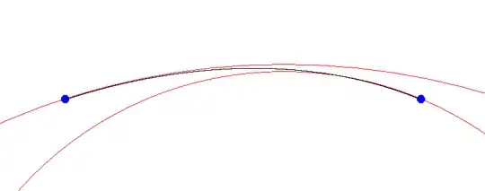

Let $l$ be the length $AB$ ($3$ miles), $h$ the size of the wall ($1$ mile), $p$ the probability that the wall appears $(1/2)$
Suppose our strategy is to walk along the curve $y = f(x)$ where $f(0) = f(l) = 0, 0 \le f(x) \le h$ for $x \in [0 ; l]$ until we hit the wall and then go around it then make a straight path to $B$.
Call $g(x)$ the length of the curve $(t,f(t))$ for $t \in [0;x]$.
The expected length of the trip is then :
$E(f) = (1-p)g(l) + \frac pl \int_0^l (g(x)+(h-f(x))+\sqrt{(l-x)^2+h^2}) dx$.
Minimizing $E(f)$ is then equivalent to minimizing $(1-p)g(l) + \frac pl \int_0^l (g(x)-f(x)) dx$, which is a combination of the total curve length, the mean curve length, and the area under $f$.
Suppose we modify $f$ locally near a point $x$, making an increase in length of $dg$ and increase in area of $da$.
This modifies $E(f)$ by $(1-p)dg + p/l((l-x)dg - da) = (1-px/l)dg - (p/l)da$, so we improve $f$ when $dg/da < p/(l-px)$ when $da,dp > 0$ and when $dg/da > p/(l-px)$ when $da,dp < 0$.
This shows that if we ever have a convex portion in our curve, we really should just cut straight through it since this modification has $dg/da < 0 (< p/(l-px))$. Therefore the optimal $f$ is concave.
The threshold on $dg/da$ translates directly into the curvature at which we can't improve our score anymore by changing the curvature. When making an infinitesimal change of curvature of an arc or radius $r$, we get an efficiency $dg/da = \kappa = 1/r$ (this is a restatement of the isoperimetric theorem)
If the curvature didn't vary this would be exact, but this method yields only a simple approximation by finding the curve from $(0,0)$ to $(l,0)$ where $\kappa = p/(l-px)$. the curvature is a increasing function of $x$, we get $r = l/p = 2l$ at the start, down to $r = l(1-p)/p = l$ at the other end.
Interestingly, it seems the solution doesn't care about what $h$ actually is until it crosses the line $y=h$
In our case, starting at $y=0$ with a slope of about $y'=0.3236$ and then numerically solving the differential equation
$y'' = \kappa(x) (1 + y'^2)^\frac 32= \frac{1}{6-x} (1 + y'^2)^\frac 32$
we obtain a curve of length about $3.0621$ miles, and an expected trip length of about $3.648$ miles
Here is what the curve looks like with the two osculating circles at the endpoints.
The correct curvature to minimize $\int A \sqrt{1+f'(x)^2} dx + \int (\int_0^{f(x)} B dy)dx$ is given by $A\kappa = \vec \nabla A . \vec n + B$ where $\vec n$ is the unit vector normal to the curve.
Taking this correction into account, you get @user5713492's solution.

One approach is via dynamic programming (which works the solution backwards). For simplicity, let's chop the $x$-axis into $n$ segments of size $\delta_x = 1/n$, and suppose the wall is on one of these chopping points (including point 0, but not point 1). Chop the $y$-axis into $m$ segments of length $\delta_y = (1/3)/m$. Define the value function $J(x,y)$ as the expected remaining travel distance to the destination under the optimal policy, given we are at a horizontal distance $x$, a vertical distance $y$, and none of our previous moves encountered a wall. The $J(x,y)$ function is defined over: $$ x \in \mathcal{X} = \{0, \delta_x, 2\delta_x, ..., 1\} \quad , \quad y \in \mathcal{Y}=\{0, \delta_y, 2\delta_y, ..., 1/3\}$$
Suppose we start at $(x_0,y_0)=(0,0)$. Working backwards, and assuming there is no wall at $x=1$, we get:
$$J(1,y) = y \quad \forall y \in \mathcal{Y} $$
Now assume $J(k\delta_x, y)$ is known for all $y$ and for some $k$. Then:
\begin{align} J((k-1)\delta_x, y) &= P[\mbox{wall is here | have not yet seen it}]\left[1/3-y + \sqrt{1/9+ (1-(k-1)\delta_x)^2}\right]\\ &+P[\mbox{wall is not here | have not yet seen it}]\min_{v\in\mathcal{Y}}\left[J(k\delta_x,v)+\sqrt{\delta_x^2 +(y-v)^2} \right] \end{align} Since we have discretized the problem, if a wall exists then it is located uniformly over one of the the $n$ points $\{0, \delta_x, ..., (n-1)\delta_x\}$. Thus, if we are at location $(k-1)\delta_x$ and have not yet seen a wall at any of the locations $\{0, \delta_x, ..., (k-2)\delta_x\}$, we get: $$ P[\mbox{Wall here | not before}]=\frac{\frac{1}{2n} }{\frac{1}{2}+\frac{1}{2}\left(\frac{n-(k-1)}{n}\right)} $$
Note: I wrote a C program to implement the above. Using $m=n$ restricts the slope options and leads to trapezoid-trajectories. That led me to incorrectly conjecture that trapezoids were optimal. Using a finer-grained slope option (as suggested by another Michael in a comment below), such as $m=100n$, gives curvy trajectories that seems consistent with two more recent answers here that look at optimizing the entire trajectory via variational analysis. Here is an optimization over the (suboptimal) trapezoid functions and for the continuous version of the problem: Let $f(x)$ be the height as a function of $x$, being the trajectory to follow until we bump into the wall (if we ever do). So we start at $f(0)=0$. A class of functions is: $$ f(x) = \left\{ \begin{array}{ll} x/3 &\mbox{ if $x \in [0, \theta]$} \\ \theta/3 & \mbox{ if $x \in [\theta, 1-\theta]$}\\ -(x-1)/3 & \mbox{ if $x \in [1-\theta, 1]$} \end{array} \right.$$
The best $f(x)$ over this class gives a minimum average distance of:
\begin{align} dist^* &= -7 + 5\sqrt{\frac{5}{2}} + \frac{1}{2}\int_{0}^1 \sqrt{1/9 + x^2}dx \approx 1.21973\\ 3dist^* &\approx 3.6592 \end{align} This is achieved by $\theta = 5 - 3\sqrt{5/2}$. This is strictly better than the naive policy of going straight until you bump into a wall, so it shows the naive policy is suboptimal.

  • I believe I have found the exact optimal trajectory. – Michael Apr 17 '16 at 00:29
  • I am surprised at how little improvement this is over the naive algorithm that just walks straight towards B from A and this optimal solution is likely an ever smaller amount better than my /\ shaped path where I go midway up to what would be an imaginary wall at mile marker $1.5$ then back down directly to B from there. However, still an interesting solution to an interesting problem. – David Apr 17 '16 at 01:15

$UPDATE~~1$: I wrote a computer program to pick only $2$ slopes, one from miles $0$ to $1$ and the other from $1$ to $2$ and it told me $.2154$ was best for the first mile and $.0346$ was best for the 2nd mile. So only "wiggling" $2$ target points, the program is already converging on the optimal position to be in at miles $1$ and $2$. The program puts us at x,y coordinates ($1$, .$2154$) and ($2$, .$2500$) which are very close to the optimal positions of ($1$, .$2182$) and ($2$, .$2547$). My next step is to try $5$ wiggle points equi-spaced (each half mile) between endpoints A ($0$,$0$) and B ($3$,$0$) but using the previous slopes as guidelines so I only need to check values close to those. For example, I know the slope for miles $0$ to $1$ should be about $.2154$ so when I bisect that leg of the journey, I only need to check slopes close to that. When I get the results of the $5$ points I will post here as another update.
$UPDATE~~2$: The program is working very well as I can easily take the output of a previous run and use it to fine tune the next run. When I bisect each leg of the walk path to get double the number of slopes (thus better approximating a curved path), I use $3/4$ for the low limit of the slope to check and $5/4$ for the high limit. To better understand this, imagine the slope of $.2154$ given to me by my program (for the 1st mile) and then I want to bisect that into $2$ slopes. Those $2$ slopes need not be the same as the single slope but likely they will be "ballpark" so that is where I get the $3/4$ and $5/4$ bounds to check. So for example, I will check all slopes between (inclusive) $3/4$ of $.2154$ and $5/4$ of $.2154$ for the $2$ segments which are miles $0$ to $0.5$ and $0.5$ to $1.0$. An even better algorithm would be to only check subslopes that are "complementary" in that the combination of them is "ballpark" to the slope they were derived from. For example: if the program tells me the slope from mile $0$ to $1$ should be around $.2154$ (which it did), then when I bisect that into $2$ slopes, if I am checking the first part of the slope for something like $0.25$, it wouldn't make sense to also check the 2nd part of the slope also at $0.25$ cuz that would put us too high at mile $1$. The idea is when you increase the first subslope beyond that of its "source" slope, to accordingly decrease the 2nd subslope, so the 2 subslopes have a combined net slope very similar to the single slope it was derived from. So basically it can be thought of as putting a hinge at each bisection of existing points, and bending the slopes slightly at the hinge, but in such a way that the endpoints of the hinge pretty much stay stationary.
It is possible to have a fast computer try out many different (x,y) points but start with a few first to get a general idea of the optimal walk path, then use that data as a starting point to then make more points with an epsilon "allowance" up or down for the possible y values. For example, write a program that starts out with only $4$ (x,y) coordinates and attempts to optimize it. Then take those $4$ points and bisect them, turning it into $7$ points but only allowing a small deviation from the $4$ points you previously optimized so that you don't have to recheck a bunch of points that are very likely not optimal. For example, suppose the first $4$ points your simulation program derives are $(0,0), (1, 0.2), (2, 0.25), (3,0)$. The next step would be to bisect those $3$ segments into $6$ but keep the $4$ previously known points close to their original values. For example, at x=$1$, only check y values from maybe $0.1750$ to $0.2250$ in small increments (perhaps $0.0001$ so only $500$ increments to check).
Also, what I like to do to help manage complexity (to help keep things as simple as possible), is after first solving the simplest case which is $4$ point, $2$ of which are the endpoints A and B (so those don't need any optimizing), is to copy that code to another file in case when I bisect the existing segments if I mess up, I can easily go back to the simpler program and start over. Also it is useful for checking and comparing other things such as path length to see how the path length changes when we add more segments (thus more closely following a curve shape).
Also, it appears to me the optimal walk curve shape can be approximated very nicely by using $8$ subpaths using fixed slopes. The path length for this is $3.06357$ miles. When I use $2999$ equidistant wall positions from miles $0.001$ to $2.999$, I get about $3.6492$ miles average walk distance so that helps confirm it is an excellent approximation to optimal. The "granularity" is set for about $0.4$ miles (direction change every $0.4$ miles approximately) with a flat section between miles $1.5$ and $1.9$. I suspect that if $2$ people walked the entire $2$ paths on a non wall day, (one taking the curved path and one taking my $8$ slope simplified path), they would never be more than about $48$ feet away from each other (according to the table at mile marker $2.2$) and would bump into each other many times. The average distance between them would be about $19$ feet. At mile $1.0$, they would be only $1$ foot apart from each other.
\begin{array}{rrrr}segment&x~mile~range&slope&y~values\\ \hline1&0.0~~to ~~0.5&.256&.000~to~.128\\ 2&0.5~~to~~1.0&.18&.128~to~.218\\ 3&1.0~~to~~1.5&.09&.218~to~.263\\ 4&1.5~~to~~1.9&0&.263~to~.263\\ 5&1.9~~to~~2.4&-.13&.263~to~.198\\ 6&2.4~~to~~2.6&-.24&.198~to~.150\\ 7&2.6~~to~~2.9&-.35&.150~to~.045\\ 8&2.9~~to~~3.0&-.45&.045~to~.000\\ \end{array}
Here is the table of the data points from someone else's solution and my simple solution where I compute the optimal y values based on a known wall position but not a known day (wall day or not). I divided my optimal y values by $2$ and they seem to almost match the other solution, especially around x=$1.4$. They are so close it is worth investigating why. The exception is they start to deviate significantly as x approaches $3$.
\begin{array}{rrrr}x&y&my~y/2&8~segment~y\\ \hline0.0&0.0000&0.0000&0.0000\\ 0.1&0.0285&0.0282&0.0256\\ 0.2&0.0556&0.0548&0.0512\\ 0.3&0.0813&0.0800&0.0768\\ 0.4&0.1056&0.1037&0.1024\\ 0.5&0.1283&0.1260&0.1280\\ 0.6&0.1495&0.1467&0.1460\\ 0.7&0.1692&0.1660&0.1640\\ 0.8&0.1872&0.1839&0.1820\\ 0.9&0.2036&0.2002&0.2000\\ 1.0&0.2182&0.2150&0.2180\\ 1.1&0.2310&0.2282&0.2270\\ 1.2&0.2421&0.2399&0.2360\\ 1.3&0.2512&0.2500&0.2450\\ 1.4&0.2583&0.2584&0.2540\\ 1.5&0.2634&0.2652&0.2630\\ 1.6&0.2663&0.2702&0.2630\\ 1.7&0.2671&0.2734&0.2630\\ 1.8&0.2654&0.2747&0.2630\\ 1.9&0.2614&0.2740&0.2630\\ 2.0&0.2547&0.2711&0.2500\\ 2.1&0.2453&0.2660&0.2370\\ 2.2&0.2331&0.2584&0.2240\\ 2.3&0.2177&0.2481&0.2110\\ 2.4&0.1991&0.2347&0.1980\\ 2.5&0.1769&0.2178&0.1740\\ 2.6&0.1508&0.1966&0.1500\\ 2.7&0.1206&0.1701&0.1150\\ 2.8&0.0858&0.1363&0.0800\\ 2.9&0.0458&0.0906&0.0450\\ 3.0&0.0000&0.0000&0.0000\\ \end{array}
A good way to approximate this table of optimal y values based on x is to use this formula (and set the endpoints to 0):
y = ($-0.00519876$ * $x^4$) + ($0.0122894$ * $x^3$) - ($0.090321$ * $x^2$) + ($0.300821$ * $x$) - $0.00014741$.
Also for simulation on a computer, I wonder if for starters (not knowing the general shape of the optimal path), if someone tried a "hold height" method, what would happen. For example, from point A, quickly (via slope $1$) go up to some fixed y (such as $0.5$) and hold it for almost the entire walk, then back down to B at the very end at slope $-1$. So the middle $2$ miles would be at y position $0.5$. Then the person could try different values for y, perhaps giving a clue of the maximum y value to never go above. This should help subsequent simulation. I may try to model this to see which y is best. It relates to this problem since it might help someone using a simulation method to narrow down the y values needed to test.
Another good yet very simple path to walk is the upper part of a trapezoid with slope $.18$ from miles $0$ to $1.5$, flat (at y=.$27$ ) from miles $1.5$ to $1.9$, then slope $-.2454545$... the rest of the way. This yields a non wall path distance of $3.0568$ and an average distance of about $3.656$ which is much closer to optimal (about $3.648$) than to naive (about $3.692$).
Lastly, someone should investigate why, when solving the known wall position problem but not knowing if it is a wall day or not, why the y values are almost exactly double those of this unknown wall position unknown wall day problem (see the graph with the $2$ plots). Up to about mile marker $1.5$ they appear to be almost identical, then start to deviate slightly and more than slightly when x approaches $3$. Why is this? It is worth investigating cuz someone could almost solve this more difficult variation simply by solving the simpler (known wall position if present) case, then just dividing the y value results by $2$. It is not optimal but is very close.
