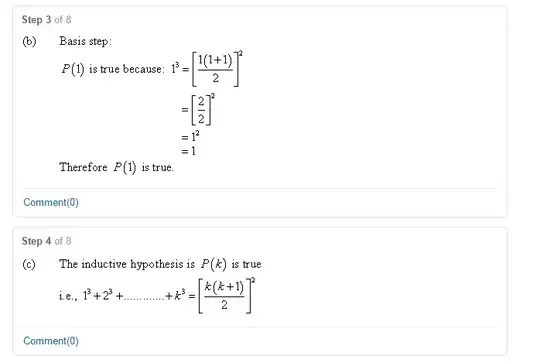

I'm taking Discrete Structures now and I can't seem to get comfortable with proof by induction. I understand the concept, and the general procedure...but it all just seems like random algebra manipulation and playing around until you get what you want. There are no specific "rules" or guidelines to follow or trends to notice that I am aware of. And if these do exist, please tell me!
For example: Let $P(n)$ be the statement that $$\forall n\in\Bbb{N}:\ 1^3+2^3+···+n^3=\left(\frac{n(n+1)}{2}\right)^{2}$$

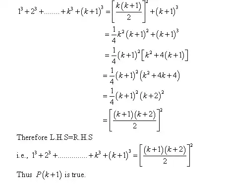

Here is the proof for it. How am I supposed to figure out if the algebraic manipulation I'm attempting is even going to lead me in the right direction? Base case and inductive hypothesis:
Proof:
proof

Remember that it is perfectly fine (although less elegant perhaps) to manipulate both the LHS and the expected RHS to reach an equality. In the proof provided in your question, they use a couple of identities that require some experience to use, and stuff like that might look like "magic" at times.
However, working out the LHS to polynomial form gives.
$$\begin{align} LHS &= \left[\frac{k(k+1)}2\right]^2+(k+1)^3\\ &=\frac14k^2(k+1)^2+(k+1)^3=\\ &=\{\text{...a couple of minutes of work...}\}\\ &=\frac14k^4+\frac32k^3+\frac{13}4 k^2+3k+1 \end{align}$$
And, expanding the expected "RHS" $\left[\frac{(k+1)(k+2)}2\right]^2$ will give you the same result and proof is done.
It's a bit tedious and not as concise, but perfectly fine, and requires less experience.

When proving result about some sum, like in your example, your advantage is that you know in advance what you want to show. In the example with $1^3+2^3+\dots+n^3$ you know that in the inductive step you would like to show the equality $$\left(\frac{n(n+1)}2\right)^2+(n+1)^3=\left(\frac{(n+1)(n+2)}2\right)^2$$ You may notice that both sides have the factor $(n+1)^2$, so this is the same as $$(n+1)^2\left(\frac{n}2\right)^2+(n+1)=(n+1)^2\left(\frac{(n+2)}2\right)^2.$$ Now you see that it suffices to show $$\left(\frac{n}2\right)^2+(n+1)=\left(\frac{(n+2)}2\right)^2,$$ which is a bit simpler.
In general, you know that you want to show that LHS is equal to RHS.
You can try to work a bit on the LHS and to make it more similar to RHS. Then, for a change, you can try to manipulate the RHS for a bit. Eventually you might get to the same expression.
