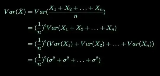

If I want to calculate the sample variance such as below:
Which becomes: $\left(\frac{1}{n}\right)^2 \cdot n(\sigma^2)= \frac{\sigma^2}{n} $...
My question is WHY does it become $$\left(\frac{1}{n}\right)^2?$$ In other words, why does the $(1/n)$ inside the variance become $(1/n)^2$?
I've read that this is because:
When a random variable is multiplied by a constant, it's variance gets multiplied by the square of the constant.
Again, though, I want to know why?
I've looked in multiple sources but they all seem to gloss over this point. I want to visually see why this is done.
Could someone please demonstrate why the $1/n$ is squared using my example?

You have that
$$\text{Var}(aX) = E[(aX)^2]-(E[aX])^2 = E[a^2 X^2]-(aE[X])^2 $$
$$=a^2 E[ X^2]-a^2(E[X])^2 $$ $$= a^2( E[X^2]-(E[X])^2 ) = a^2 \text{Var}(X)$$
edit : or this one may be more basic (depending on your definition of variance)
$$\text{Var}(aX) = E[(aX-E[aX])^2 ] = E[(aX-aE[X])^2 ] $$
$$=E[a^2(X-E[X])^2 ] $$ $$= a^2E[(X-E[X])^2 ] = a^2 \text{Var}(X)$$
