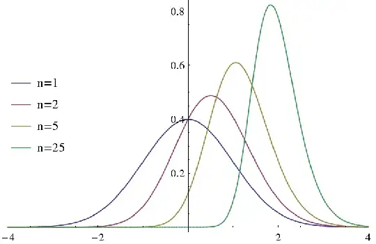

Here's what the PDF looks like for various values of n:
Of course, n=1 is just the standard normal distribution itself.

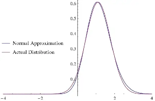

Except for n=1, these aren't normal distributions, but can be approximated as such. For n=5, for example,
$\{\mu \to 1.11241,\sigma \to 0.656668\}$ and the graph looks like this:
The integral of the difference squared from $-\infty$ to $\infty$ is about 0.000848615

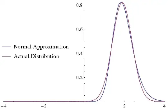

For n=25, $\{\mu \to 1.89997,\sigma \to 0.486849\}$:
with an error squared of 0.00331485.
In both cases, I used numerical methods to minimize integral of the difference squared (ie, the "error" squared).
