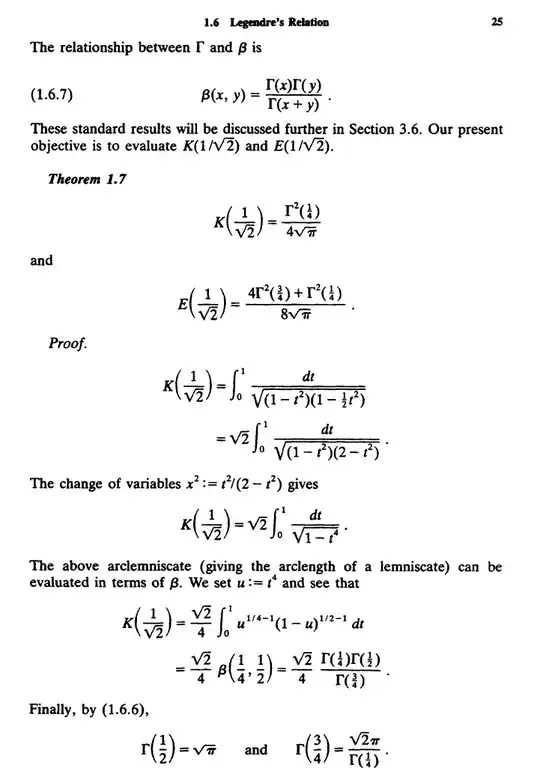

This method is the famous AGM method and you may find too in page 6 of Sebah and Gourdon's postscript paper on Gamma (or here) that : $$\displaystyle \Gamma\left(\frac 14\right)^2=\frac{(2\pi)^{3/2}}{AGM(\sqrt{2},1)}$$
You may find in the excellent book of the Borweins "Pi and the AGM" following derivation using the complete elliptic integral of the first kind $\rm{K}$ : page25

    The key point is that the gamma function for small rational arguments agrees with certain values of the complete elliptic integral of the first kind, and the AGM is a very efficient way to numerically evaluate the complete elliptic integral. I might write a few more details later... – J. M. ain't a mathematician Jul 11 '12 at 00:12
  • I'll just note that in the extract from the Borweins' book, they use the modulus $k$ as the argument of the complete elliptic integrals instead of the parameter $m$ that I used in my answer. The two conventions are related, though: $m=k^2$. Thus, the $K\left(\dfrac1{\sqrt2}\right)$ of Borwein corresponds to $K\left(\dfrac12\right)$ in my answer. – J. M. ain't a mathematician Jul 13 '12 at 19:28
  • @J.M.: I noticed that too : the online definitions of $\rm{K}$ all use $\sqrt{1-k^2t^2}$ in the integral these days (including Weisstein) while A&S and Alpha/Mathematica use $\sqrt{1-kt^2}$. So that the parameters should usually be squared before being proposed to Alpha (to make things even more confusing Alpha changes the simple parameter $p$ in $p^2$ but not if written $p^1$ :-)). – Raymond Manzoni Jul 13 '12 at 19:59
    Right; Mathematica /Wolfram Alpha and Abramowitz and Stegun use the parameter (I point to A&S as my reason for preferring the parameter convention), while Maple, MATLAB, MathWorld and DLMF use the modulus convention. Moral lesson being, figure out what convention your author is using first before applying any formula containing elliptic integrals (and elliptic functions, too), and always mention what convention you're using in your writing. – J. M. ain't a mathematician Jul 13 '12 at 23:54

  • +1: Thanks for the detailed addition J.M.! The paper of Borwein&Zucker doesn't seem freely available so that I added a scan of Borwein's book in my answer for the case $\Gamma(1/4)$. Available where the "AGM revisited" from Borwein&all and another paper a little linked to the other elliptic integral thread of these days... here – Raymond Manzoni Jul 13 '12 at 19:11
  • Yeah, it's a bit inconvenient that there's no freely accessible version of that paper, so I tried to list at least the simpler results from that paper. If you're interested in seeing it too, I suppose I could send you a copy... – J. M. ain't a mathematician Jul 13 '12 at 19:14
  • Thanks J.M. but it won't be needed. The general idea is pretty clear from the book 'Pi and the AGM' I'm reading these days (very interesting if not cheap). Cheers, – Raymond Manzoni Jul 13 '12 at 19:21
