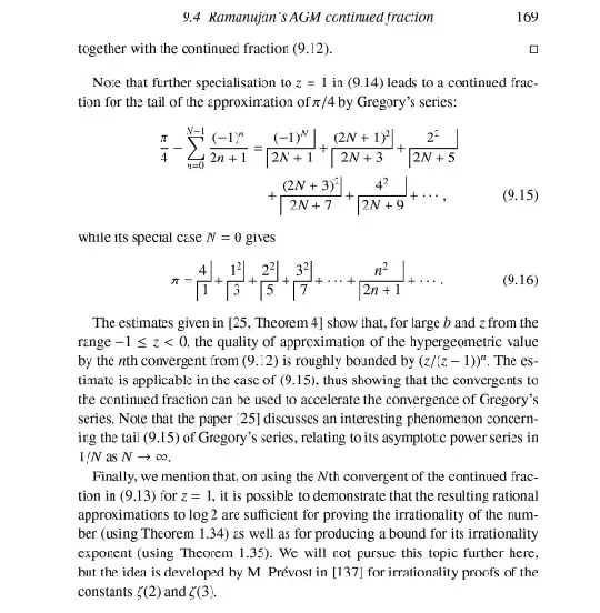

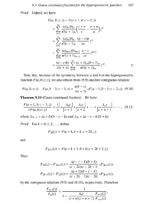

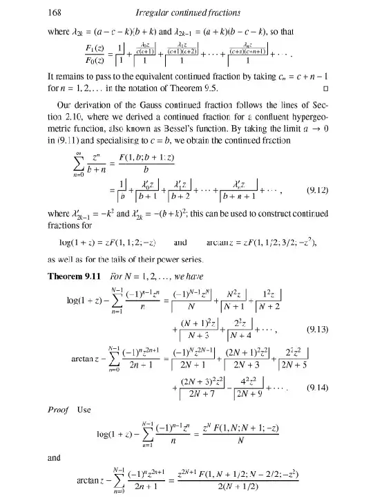

Your continued fraction appears too in a neat and recent book by Borwein, van der Poorten, Shallit, Zudilin "Neverending Fractions: An Introduction to Continued Fractions" at the end of the pages $167-169$ reproduced for convenience here (hoping there is no problem with that...) :
p167 p168 p169
