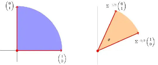

The illustration below shows that the probability that $\pmatrix{X\\Y}$ lies in the upper quadrant (in blue), is the same as the probability that $\pmatrix{U\\V}$ lies in the wedge (in orange). Since the distribution of $\pmatrix{U\\V}$ is rotationally invariant, simple geometry gives $\mathbb{P}(X>0,Y>0)={\theta\over 2\pi}.$
With $v=\Sigma^{-1/2}\pmatrix{0\\1}$ and $w=\Sigma^{-1/2}\pmatrix{1\\0},$ we have $\cos(\theta)=\langle v,w\rangle /\|v\| \|w\|.$ But \begin{eqnarray*} \langle v,w\rangle &=& (0\ 1)\,\Sigma^{-1}\pmatrix{1\\0}=-\rho/(1-\rho^2)\\[5pt] \|v\|^2&=&(0\ 1)\,\Sigma^{-1}\pmatrix{0\\1}=1/(1-\rho^2)\\[5pt] \|w\|^2&=&(1\ 0)\,\Sigma^{-1}\pmatrix{1\\0}=1/(1-\rho^2), \end{eqnarray*} so that $\cos(\theta)=-\rho.$ Putting it all together gives $$\mathbb{P}(X>0,Y>0)={\arccos(-\rho)\over 2\pi}.$$

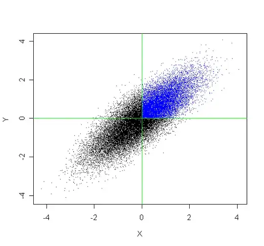

Here is a plot of 30,000 (out of a million) $(X, Y)$ pairs simulated.
