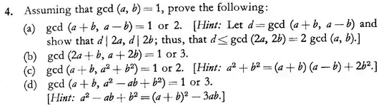

I have been trying to solve these but have had no success. Please help by giving hints not answers.
None
Assuming that $\gcd(a,b)=1$ prove the following:
(a) $\gcd(a+b,a-b)=1$ or $2$. [Hint: Let $d=\gcd(a+b,a-b)$ and show that $d\mid 2a$, $d\mid 2b$; thus $d\le \gcd(2a,2b) = 2\gcd(a,b)$]
(b) $\gcd(2a+b,a+2b)=1$ or $3$.
(c) $\gcd(a+b,a^2+b^2)=1$ or $2$. [Hint: $a^2+b^2=(a+b)(a-b)+2b^2$.]
(d) $\gcd(a+b,a^2-ab+b^2)=1$ or $3$. [Hint: $a^2-ab+b^2=(a+b)^2-3ab$]
Source: Elementary Number Theory by David M. Burton

  • It is difficult to give hints, not answers, since the supplied hints are close to what one might have given. But for Question (b), note that if $d$ divides both then $d$ divides $2(2a+b)-(a+2b)$, that is, $d$ divides $3a$. Similarly, $d$ divides $3b$. – André Nicolas Feb 29 '16 at 06:27

    The main tool you will need to use is this: you can add any multiple of one number to the other number and the greatest common divisor won't change. In other words, $\gcd(a,b)=\gcd(a,b+ka)$ for any integer $k$. (Do you know why this tool is true?) – Greg Martin Feb 29 '16 at 08:31

Let $u = a + b$ and $v = a - b$. Clearly $u$ and $v$ are both odd or both even. Express $a$ and $b$ in terms of $u$ and $v$.
$\gcd(m,n) = g$ if and only if g is the smallest positive integer that can be expressed as $\alpha m + \beta n = g$
So there exists integers $\alpha$ and $\beta$ such that $\alpha a + \beta b = 1$ Change that into an expression involving $u$ and $v$ and go from there.
