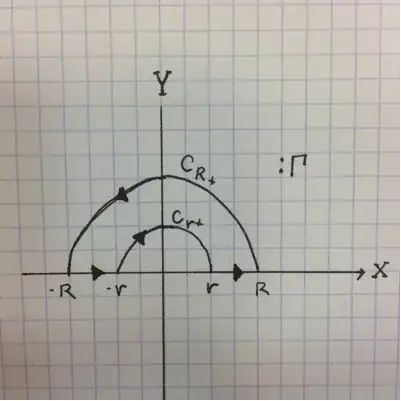

$$\int_{0}^{+\infty}\frac{\sin x}{x}dx$$
My start:
Zero is a singular point, Let's define $g(z):=(e^{iz})\big/z$
$$\int_{\Gamma}\frac{e^{iz}}{z}dz=\\ \int_{-R}^{-r}\frac{e^{ix}}{x}dx+\int_{C_r^+}\frac{e^{iz}}{z}dz+\int_{r}^{R}\frac{e^{ix}}{x}dx+\int_{C_R^+}\frac{e^{iz}}{z}dz$$
$$=\int_{r}^{R}\frac{e^{ix}-e^{-ix}}{x}dx+\int_{C_r^+}\frac{e^{iz}}{z}dz+\int_{C_R^+}\frac{e^{iz}}{z}dz$$
from here I'm stuck the final answer should be $\pi /2$
$$(*)\lim\limits_{r\to 0}\int_{C_r^+}\frac{e^{iz}}{z}dz$$
$$(**)\lim\limits_{R\to 0}\int_{C_r^+}\frac{e^{iz}}{z}dz$$

  • The LHS = 0 - no residues - as you surely know. You need to evaluate - again, as you surely know - the limits of $()$ and $(*)$. So write out the integrals explicitly. The integrals are over semi-circles: parametrize them by $\theta$: $z= re^{i\theta}$ and $z= Re^{i\theta}$. – peter a g Jan 31 '16 at 15:44
  • @peterag $\pi /2$, this is what the book says – 3SAT Jan 31 '16 at 15:47
  • Oh sorry - I misread the question: I thought you wanted the integral over the entire real line. Yes $\pi/2$. (I just edited out the offending line above.) Over the entire real line it is $\pi$. – peter a g Jan 31 '16 at 15:49
