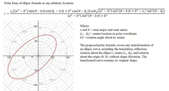

I write the ellipse polar form formula in this link https://www.desmos.com/calculator/gkijxayubk. The independent variable is theta and the dependent variable is r. Where a and b are semi major and semi minor, (r_o, theta_o) is the ellipse center location's polar coordinate, and k*pi is the rotation angle about its center. I also publish the curve fitting of raw data resemble an ellipse shape in this link https://doi.org/10.3390/f14061102
The formula is in the attached picture. the polar formula of an ellipse

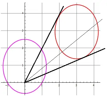

HINTS:
For a start we can use standard parametric equations $ (r,\theta),(x,y) $ and then convert to Cartesian coordinates, translate by $ (h,k) $ re-convert to required polar equation $ \rho = f( \gamma ). $
$$ r= p/ (1- \epsilon \cos \theta) ; x= r \cos\theta + h ; y= r \sin \theta +k ; \rho^2 = x^2 + y^2 ; \gamma = \tan^{-1} {\frac{y}{x}}; $$
There are two ellipse tangent limits for $\gamma$ limits each of constant value, two variable radius $\rho$ limits for each intermediate $\gamma$ value as shown.
Mathematica program if helpful:
ecc = 0.6; p = 1.; h = 3.; k = 2.; r[t_] = p/(1 - ecc Sin[t]);
ell = ParametricPlot[ r[t] {Cos[t], Sin[t]}, {t, 0, 2 Pi},
   PlotStyle -> {Thick, Magenta}];
rho[t_] = Sqrt[r[t]^2 + h^2 + k^2 + 2 r[t] ( h Cos[t] + k Sin[t])];
gam[t_] = ArcTan[   r [t] Cos[t] +h, r [t] Sin[t] +k ] ;
displ = ParametricPlot[
   rho[t] {Cos[gam[t]], Sin[gam[t]]}, {t, 0, 2 Pi},
   PlotStyle -> {Thick, Red}];
Show[{ell, displ}, PlotRange -> All, GridLines -> Automatic]
DisplEllipse
To find polar angle $ \gamma $ of tangential contact to radius vector, next use the condition
$$ \frac{d \gamma}{d \rho} =0 $$
and then proceed radial transversal intersection limits...
(If you want to locate target area of displaced ellipses, calculation with pole/polar of ellipse is perhaps best, but it is not mentioned here).

  • Can't make any sense of this text. –  Jan 11 '16 at 09:41
  • Any clearer with the update? – Narasimham Jan 11 '16 at 11:17
    This is a little clearer (at least you defined $\gamma$) but the final answer still doesn't stand out. Fragments like "proceed radial transversal intersection limits" are meaningless. –  Jan 11 '16 at 11:24
  • I left it to him to take it further along the preferred polar route he passionately indicated in the title and third para. – Narasimham Jan 11 '16 at 11:34
