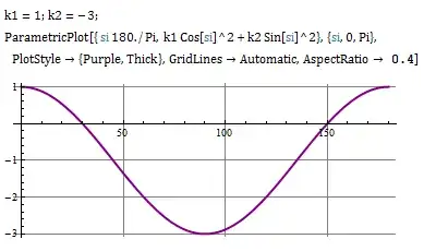

Their normal curvatures follow Euler's law
$$ k_n = k_1 \cos^2 \alpha + k_2 \sin ^2 \alpha \tag{1} $$
respectively for 180 degree rotation the four $k_n's $ are minimum,0,maximum,0.. which repeat as follows at $0, 30, 90, 150, 180 ...$ degrees for curvature ratio at a point in all directions of a tangent bundle
$$ \frac{k_1}{k_2} = - \frac{1}{3} \tag{2}$$
as shown in the graph including asymptotic directions $ \alpha = \tan^{-1}\sqrt{\frac{1}{3}} = 30^{\circ} $ for the 4 important geodesics :
