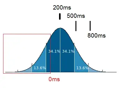

After meassuring the answer time of a software system I calculated the standard deviation from the samples. The average time is about 200ms, the standard deviation $$\sigma = 300ms$$ According to the image below this should mean that 68.2% of all response times should be between -100ms and 500ms.
enter image description here Image:https://en.wikipedia.org/wiki/Standard_deviation
A negative response time makes obviously no sense. How should the part of the normal distribution be interpreted that is enclosed in the red box?

You have assumed a normal distribution for a data which cannot be negative. It doesn't make sense at all. You can use lognormal distribution instead. It is used in Black-Scholes model for pricing options. (Stock prices cannot be negative)
Obviously, I can't tell you if your sample fits such a distribution if I don't have access to the full dataset.

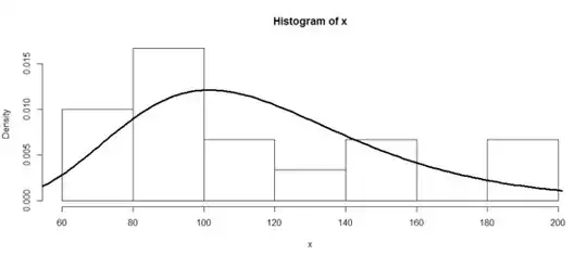

r-script:
require(MASS)
hist(x, freq=F)
fit<-fitdistr(x,"log-normal")$estimate
lines(dlnorm(0:max(x),fit[1],fit[2]), lwd=3)
(x is a sample vector)
Obviously, your sample is way too small here.

As others have mentioned, the normal distribution doesn't make much sense here. We sometimes use a normal distribution, despite the possibility of negative values that don't make sense, when the probability of such values under the normal distribution is very small. But here the standard deviation is greater than the mean, so that probability is not small at all (about $1/4$).
A glance at your data suggests that a heavy-tailed distribution might be appropriate: much of the standard deviation comes from that one very large value of $1500$.
