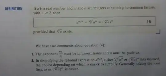

A common source of confusion or "paradoxes" comes from not paying close attention to the (perhaps rarely exercised) restrictions or boundary conditions. These restrictions are necessary to ensure that paradoxes like you're considering do not arise (i.e., otherwise the definitions would fail to be well-defined). For example, here's a proper definition of rational exponents from Michael Sullivan's College Algebra:
Definition of rational exponents
Note that we only consider real numbers here. Now, to answer your questions:
But since $\sqrt{x} = x^{\frac{1}{2}}$ shouldn't $\sqrt{x^2} = (x^2)^{\frac{1}{2}} = x^{\frac{2}{2}} = x$ because of the exponents multiplying together?
The first assertion is not generally true; $\sqrt{x} = x^{\frac{1}{2}}$ only provided that $\sqrt{x}$ exists (that is, not for negative $x$). In your chained equality, the second equality is false, because the exponent in $x^{\frac{2}{2}}$ contains common factors (i.e., is not in lowest terms). These statements would, however, be true if $x$ was restricted to positive real numbers only.
Also, doesn't $(\sqrt{x})^2$ preserve the sign of $x$? But shouldn't $(\sqrt{x})^2 = (\sqrt{x})(\sqrt{x}) = \sqrt{x^2}$?

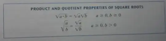

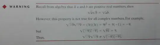

All of these equalities are false for negative $x$, because in that case the expression $\sqrt{x}$ does not exist in real numbers (i.e., it's undefined). Likewise, if you look carefully at the rule for multiplying radicals, then you'll see the same restriction against square roots of negative numbers.
Edit: Added text from Precalculus: a right triangle approach by Ratti & McWaters. Hopefully this clarifies the rule for products of square roots (namely that only positive radicands can be generally combined or separated). Also, note the warning from the section on complex numbers that doing so in that case is illegitimate.
Product and quotient properties of square roots
Warning against combining products of complex square roots
  • The proper definition in the photo says $a$ need only be a real number, implying that it can be negative. It doesn't say $\sqrt a$ needs to be a real number. So using that definition, the paradox seems to apply.
    Supposing that $\sqrt x = x^\frac 1 2$ only provided that $\sqrt x$ exists, what does $x^\frac 1 2$ equal if $x$ is negative?
    Why should the equalities be false for negative $x$ because $\sqrt x$ is imaginary? As soon as the two imaginary numbers multiply together they become a real number.
    – Kyle Delaney Dec 12 '15 at 04:33
    No, this whole definition is only in the context of real numbers; the clause "provided that $\sqrt[n]{a}$ exists" is in fact saying that it must be a real number (otherwise it would be an empty statement). And again, multiplying radicals is only ever defined if at least one radicand is nonnegative. Seriously, you need to read the definitions carefully. – Daniel R. Collins Dec 12 '15 at 05:25
  • Edited to add more clarifying text from the Ratti & McWaters Precalculus text. – Daniel R. Collins Dec 12 '15 at 06:03
