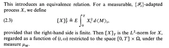

This can brings confusion when some authors want to rush things and introduce a notation at the same time they make something on the notation. In particular, I got stuck for a while with this definition, from Brownian Motion and Stochastic Calculus - Karatsaz, Shreve.
im
Just to clarify, they use that equal symbol with a triangle over it for definition (it works just as ":=" works). Clearly $[X]_T^2$ is not a symbol to be defined, but the power of $2$ over the symbol $[X]_T$, which was NOT defined. In fact, the authors expect us to guess they made an operation over a definition at the same time they made the definition. I got stuck a while with this. You may argue it's obvious, but I thought $[X]_T$ was some earlier definition I missed and $[X]_T^2$ was not the power of $2$ of $[X]_T$, but something like "$[X]_T$ of order $2$".
To be honest, the very fact that they introduced $[X]_t^2$ as a definition was the reason why I wasn't able to see this as a power of $2$. I never thought it was possible to introduce a notation and make something on this notation at the same time, so I treated $[X]_T^2$ as single symbol defined by the expression given.
I have two questions: Is wrong my understanding about how definitions are made or the authors of this book really made some kind of abuse? If they really made some kind of abuse, how commom is this pratice? I'm really concerned about this, because if this abuse is commom, I will have to read any definition with doubled care from now.

    You can define the symbol $\sqrt{X}$ to be anything you want in your argument, but it's really not good style if it's inconsistent with other definitions of square root, your reader will have to understand things in context. Plus, you have to be careful when doing this that you don't accidentally employ "proof by notation". – Gregory Grant Dec 08 '15 at 16:02
  • Here's another way that the author could have done it. Take $[X]^2_T$ to be the first symbol to be defined. Then take $[X]_T$ to be the second symbol to be defined, and its definition is $[X]_T = \sqrt{[X]^2_T}$. Then observe that $([X]_T)^2 = [X]_T^2$, where the superscript $2$ on the left hand side is ordinary exponentiation. Then say "Henceforth, we are free to interpret the superscript $2$ on the notation $[X]_T^2$ as an exponent". Still, though, it is quite common for authors to avoid all of that and to take exactly the shortcut that this author took. – Lee Mosher Dec 08 '15 at 16:08
  • And yes, if you have a reason to double your care in reading definitions, you should take it. – Lee Mosher Dec 08 '15 at 16:10
It appears that the authors define $[\square]^2_\square$ which takes as "input" (the two square boxes) a measurable process (your $X$) and a positive real number ($T$ in your text). As such, nothing like $[\square]_\square$ seems to be defined herre and the reader may even suspect that the $[X]_T$ occurring a line later might be a typo (especially in a context where things like $L^2$-norm occur, which are not the square of some "$L$-norm"); in fact this context suggests the natural interpretation of a possible generalized definition $[X]_T^p\triangleq E\int_0^TX^pd\langle M\rangle_t$ and of course this would in general result in $\sqrt[p]{[X]_T^p}\ne \sqrt{[X]_T^2}$.
I agree with you that what the author wants to define and therefore should have written is $$\tag{2.3} [X]_T\triangleq\sqrt{E\int_0^TX^2d\langle M\rangle_t}$$ Or at least he might have formulated it properly as the implicit definition that it is:
"We define $[X]_T$ as the nonnegative number satisfying $[X]_T^2={E\int_0^TX^2d\langle M\rangle_t}$" (note the equal sign).
It may be the case that the super-size surd caused some typesetting problems.
