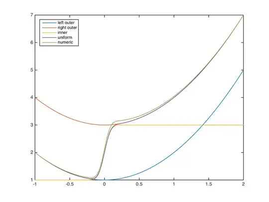

Of course we want to look at a picture too. The numerical solution wasn't easy to get, I usually use a simple shooting method and an ODE solver, but for this I had to use a BVP solver. In this picture, $\epsilon=0.01$ (boundary layer $\sim0.1$ wide) enter image description here
I also used symbolic algebra to calculate the residual when you substitute $y_{unif}$ into the original differential equation. The result was $$ 2\epsilon\left(\mathrm{erf}\left(\frac{x}{\sqrt\epsilon}\right) + x^2 + 3\right) $$ which is indeed $O(\epsilon)$ in $[-1,2]$, so everything looks alright.
