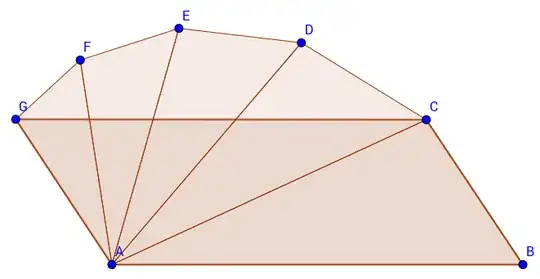

I take for granted that $x^5-x+1=0$ has Galois group $S_5$ and hence is not solvable by radicals. It can be translated into a geometric problem:
Given $A,B$, find all remaining point so that you obtain a figure where
  • triangles $ABC$, $ACD$, $ADE$, $AEF$, $AFG$ are similar
  • $ABCG$ is a parallelogram
Note that identifying $\vec{AB}$ with $1\in\Bbb C$ and $\vec{AC}$ with $x\in\Bbb C$, the first bullit point ensures that $\vec{AG}=x^5$ and the second ensures that $x^5+1=x$.
