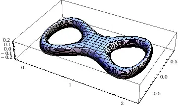

Here is a general recipe for a polynomial whose level set is an $n$-torus in $\mathbb R^3$.
First, take the polynomial $$\begin{align}f(x) &= \prod_{i=1}^n (x-(i-1))(x-i) \\ &= x(x-1)^2(x-2)^2\cdots(x-(n-1))^2(x-n)\end{align}$$ which is positive as $x\to\pm\infty$, crosses zero at $x=0$ and $x=n$, and touches zero from below at $i = 1, 2, \ldots, n-1$. Examples: $n=1$, $n=2$, $n=5$.
Then let $$g(x,y) = f(x) + y^2,$$ so that the set of points $g(x,y)=0$ forms $n$ connected loops ($n=1$, $n=2$, $n=5$). Finally, define $$h(x,y,z) = g(x,y)^2 + z^2 - r^2,$$ which "inflates" the loops in three dimensions. For small enough $r$, the level set $h(x,y,z) = 0$ is an $n$-torus. For example, here's $n=2$ and $r=0.1$, for which the zero level set of $h(x,y,z) = \left(x(x-1)^2(x-2)+y^2\right)^2+z^2 - 0.01$ is plotted:

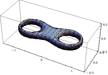

Now, to generate a double torus from these lemniscates, if you have the implicit Cartesian equation in the form $F(x,y)=0$, you can perform the "inflation" step of Rahul's approach; that is, form the equation
$$F(x,y)^2+z^2=\varepsilon$$
where $\varepsilon$ is a tiny number.
For instance, here's a double torus formed from the lemniscate of Bernoulli: $$((x^2+y^2)^2-x^2+y^2)^2+z^2=\frac1{100}$$
