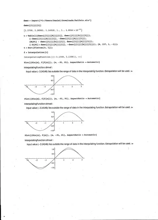

Finally, the hardest bit is when the fixpoint has derivative $1.$ I spent quite a bit of time finding a half-iterate for $\sin x.$ It works, the result is in between the sine wave and a sawtooth curve (of line segments) that is tangent to the sine curve at multiples of $\pi.$ And, for $0 < x < \pi,$ it is real analytic. I wrote to Jean Ecalle, it turns out that the function really is $C^\infty$ when we expand to include $x=0,$ therefore $C^\infty$ on the entire real line. Let's see, amplitude a little larger than $\sin x$ itself, not as large as the sawtooth; $\pi/2 \approx 1.570796,$ and we get $f_{1/2} (1.570796) \approx 1.140179.$
The (substantial) work is summarized at https://mathoverflow.net/questions/45608/formal-power-series-convergence/46765#46765
As commented, Helmuth Kneser constructed a real analytic half-iterate for $e^x.$ At about the same time I did $\sin x,$ I also did $e^x-1,$ which has a fixpoint with derivative $1$ at $x=0.$ Once again, real analytic for $x > 0,$ also for $x < 0,$ but just $C^\infty$ on the whole real line. Having trouble posting the picture, partly because it is a jpeg instead of a pdf. Anyway, the outcome is that $\log x$ works, but $\log (1+x)$ is more difficult.

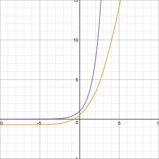

This question already has a great answer, but I thought that you might like to see an actual piecewise construction of such a function (defined on $(-\ln(2),\infty)$). My function is not analytic, but it is continuous and differentiable on $\mathbb R$.
First notice that if we find a function $h$ with the property $$(h\circ h)(x)=e^x$$ then it follows that $$(h^{-1}\circ h^{-1})(x)=\log(x)$$ and we may use $h^{-1}=\text{sog}$.
Okay, this piecewise definition gets a bit gross, so bear with me.
Define a sequence $a_n$ as follows: $$a_{-1}=-\log(2),\space\space a_0=0$$ $$a_{n+2}=\exp(a_n)$$ and define a sequence of functions $H_n$ as follows: $$H_{-2}(x)=\log(e^x+0.5)$$ $$H_{n+1}(x)=\exp(H^{-1}_n(x))$$ Then one may show verify rather simply that the function $$h(x) = \left\{ \begin{array}{lr} H_{-2}(x) & : -\infty \lt x \le -\log(2)\\ H_n(x) & : a_n\lt x \le a_{n+1} \end{array} \right.\\$$ satisfies $(h\circ h)(x)=e^x$. If it helps, I can write the definition out for you this way: $$h(x) = \left\{ \begin{array}{lr} \ln(e^x+0.5) & : -\infty \lt x \le -\log(2)\\ e^x-0.5 & : -\log(2)\lt x \le 0\\ x+0.5 & : 0\lt x \le 0.5\\ e^{x-0.5} & : 0.5\lt x \le 1\\ \text{etc}...\\ \end{array} \right.\\$$ With a bit more difficulty (and induction), one may prove that it is differentiable on $\mathbb R$ (unfortunately, it is not twice differentiable). Here is a its graph (in orange) alongside a graph of $y=e^x$ (in purple):

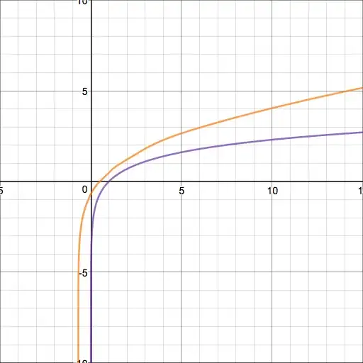

Now, for $\text{sog}(x)$, all we need to do is graph $y=h^{-1}(x)$:
