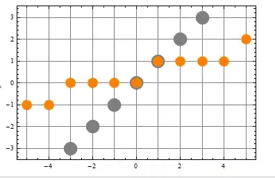

Let $\mathbb{Z} \ni k = \lfloor \frac{6 x+ 5}{8} \rfloor$. Then the equation says $x = \frac{k}{3} + \frac{7}{15}$. Now we write the equation for $k$: $$ k = \left\lfloor \frac{k}{4} + \frac{39}{40} \right\rfloor $$ It now remains to test few small values of $k$. Values $k=0$ and $k=1$ work out. enter image description here
These correspond to $x = \frac{7}{15}$ and $x=\frac{12}{15} = \frac{4}{5}$.
