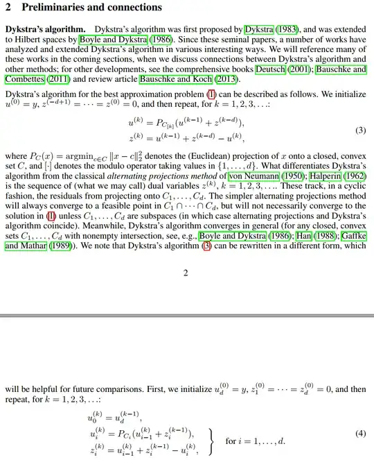

Projection on Convex Sets (POCS) / Alternating Projections does exactly what you want in case your sets $ \left\{ \mathcal{C}_{i} \right\}_{i = 1}^{m} $ are sub spaces.
Namely if $ \mathcal{C} = \bigcap_{i}^{m} \mathcal{C}_{i} $ where $ {\mathcal{C}}_{i} $ is a sub space and the projection to the set is given by:
$$ \mathcal{P}_{\mathcal{C}} \left( y \right) = \arg \min_{x \in \mathcal{C}} \frac{1}{2} {\left\| x - y \right\|}_{2}^{2} $$
Then:
$$ \lim_{n \to \infty} {\left( \mathcal{P}_{\mathcal{C}_{1}} \circ \mathcal{P}_{\mathcal{C}_{2}} \circ \cdots \circ \mathcal{P}_{\mathcal{C}_{m}} \right)}^{n} \left( y \right) = \mathcal{P}_{\mathcal{C}} \left( y \right) $$
Where $ \mathcal{P}_{\mathcal{C}_{i}} \left( y \right) = \arg \min_{x \in \mathcal{C}_{i}} \frac{1}{2} {\left\| x - y \right\|}_{2}^{2} $.
In case any of the sets isn't a sub space but any convex set you need to use Dykstra's Projection Algorithm.
In the paper Ryan J. Tibshirani - Dykstra’s Algorithm, ADMM, and Coordinate Descent: Connections, Insights, and Extensions you may find extension of the algorithm for $ m \geq 2 $ number of sets:
