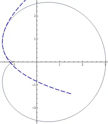

One way to geometrically interpret the third derivative is in the notion of the osculating parabola. In much the same way that the first derivative enters into the defining equation for the tangent line (the line that best approximates your curve in the vicinity of a given point), and that the second derivative is involved in the expression for the osculating circle (the circle that best approximates your curve in the vicinity of a given point), the third derivative is required for expressing the osculating parabola, which is the parabola that best approximates... oh, you catch on quick. ;)
More specifically, if you remember the fact that four points uniquely determine a parabola, you can think of the osculating parabola as the limiting case of the parabola through four neighboring points of a given curve when those four points coalesce, or come together. The so-called aberrancy (a translation of the French "déviation") is the tangent of the angle the axis of the osculating parabola makes with the normal line, and is given by the formula
$$\tan\,\delta=\frac1{3\varrho}\frac{\mathrm d\varrho}{\mathrm d\phi}=\frac{\mathrm d y}{\mathrm d x}-\frac{1+\left(\frac{\mathrm d y}{\mathrm d x}\right)^2}{3\left(\frac{\mathrm d^2 y}{\mathrm d x^2}\right)^2}\frac{\mathrm d^3 y}{\mathrm d x^3}$$
where $\varrho$ is the radius of curvature and $\phi$ is the tangential angle.
From these considerations, one could derive an expression for the osculating parabola: given a curve represented parametrically as $(f(t)\quad g(t))^T$, the parametric equations for the osculating parabola of the curve at $t=t_0$ are
$$\begin{pmatrix}f(t_0)\\g(t_0)\end{pmatrix}+\frac{\varrho\;\cos^4\delta}{2}\begin{pmatrix}\cos\,\phi&-\sin\,\phi\\\sin\,\phi&\cos\,\phi\end{pmatrix}\cdot\begin{pmatrix}(u^2-2)\tan\,\delta-2u-\tan^3\,\delta\\(u+\tan\,\delta)^2\end{pmatrix}$$
Here for instance is the cardioid $(2\cos\,t+\cos\,2t\quad 2\sin\,t+\sin\,2t)^T$ and its osculating parabola at $t=2\pi/3$:
cardioid and osculating parabola
